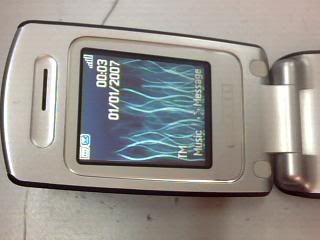

ALCATEL OT-C701 HANG, successfully format by Z3X LG + DRAGON BOX as an interface.
ALCATEL OT-C701 HANG on logo, successfully format by Z3X LG + DRAGON BOX as an interface.
ALCATEL OT-C701 HANG ON LOGO

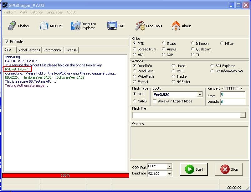

format lang sa Z3X MTKtool V1.8.0.2 with GPGDRAGON BOX as na interface (para hindi na mag hinang ng cable pinout)
procedure:

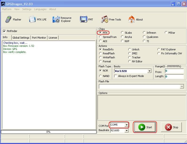

DRAGON SW
>run dragon sw
>connect
>select mtk
>click start (press power on key para madetect ang pinout

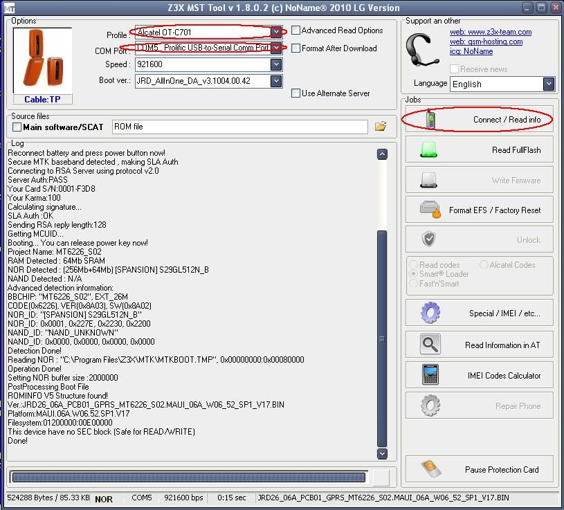

Z3X sw
>run z3x MTKtool V1.8.0.2
>select OT-C701 (model)
>select comport (same as dragon box comport)
>click connect / read info
>press power on key

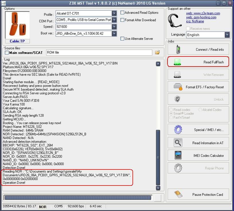

>read fullflash ( pinaka iportante sa lahat)

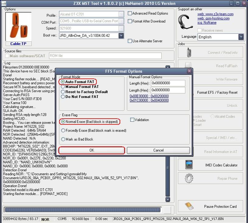

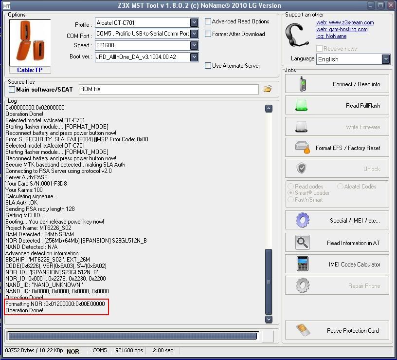

>click Format Efs / Factory reset
>window will pop up for format option
>check auto format fat & normal erase ( bad block is skipped )
>click OK
DONE
