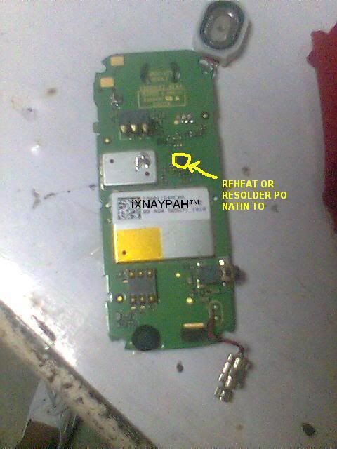

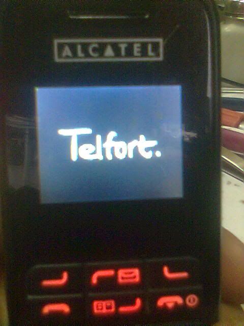

Nakailang papalit palit ng cable at ilang beses ko na din binaligtad still no luck pa din ..RTO ko na sana kasi naka 30mins na ko eh, buti nalang sabi ng customer babalikan nalang daw nya. BUTI NALANG... trace ko line RX at TX at eto nakita ko, sabay reheat nadin hehehe...
Matapos ko po reheat at resolder yung part, eto po result....

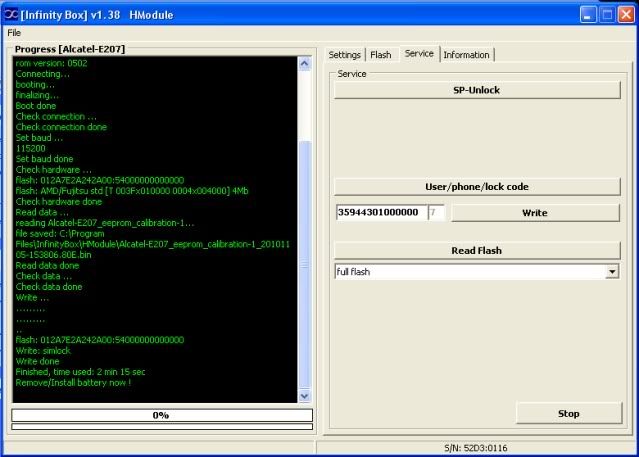

COM7 [VCP0] selected
Code:
COM7 [VCP0] selected module v1.38 Device: Alcatel-E207 "advanced chip detection" active Action: unlock Checking data, wait... Boot ... Phone should be Switched OFF ! Press Power button now !
module v1.38
Action: unlock
Boot ...
rom version: 0502
Connecting...
booting...
finalizing...
Boot done
Check connection ...
Check connection done
Set baud ...
115200
Set baud done
Check hardware ...
flash: 012A7E2A242A00:54000000000000
flash: AMD/Fujitsu std [T 003Fx010000 0004x004000] 4Mb
Check hardware done
Read data ...
reading Alcatel-E207_eeprom_calibration-1...
file saved: C:\Program Files\InfinityBox\HModule\Alcatel-E207_eeprom_calibration-1_20101105-153806.80E.bin
Read data done
Check data ...
Check data done
Write ...
Write: simlock
Write done
Finished, time used: 2 min 15 sec
Remove/Install battery now !

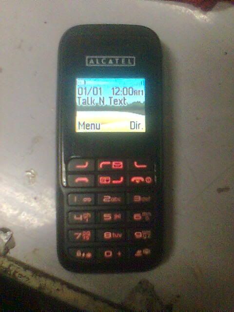

nababasa na sya pag click ko sp-unlock
Eto po finish product:
SANA PO MAKATULONG.....
