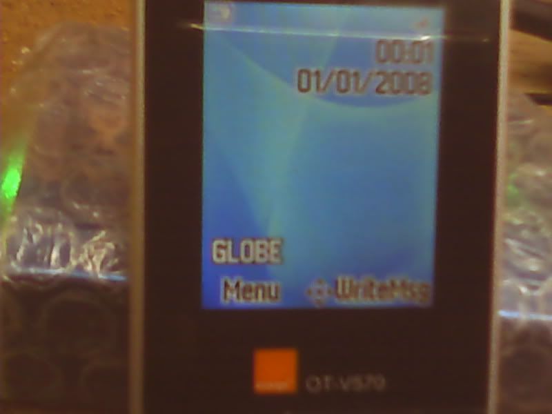

alcatel ot-v570 unlock! procedure and files inside,...[Reference]
share ko lang po mga amo alcatel ot-v570 unlock!
1st-fullflash backup and eeprom para safe,.hehe
2nd-download nyo po simfree firmware,link below,.
3rd-on flash tab, check "format ffs"
4th-load firmware
5th-write flash
6th-hold power on hanggang mag-on sya,.

Finished, time used: 1482 sec
Remove/Install battery now !
File system has been modified !
It is need to press and HOLD phone "Power" button
during long time (up to 1 min) to make phone Powered-On !
