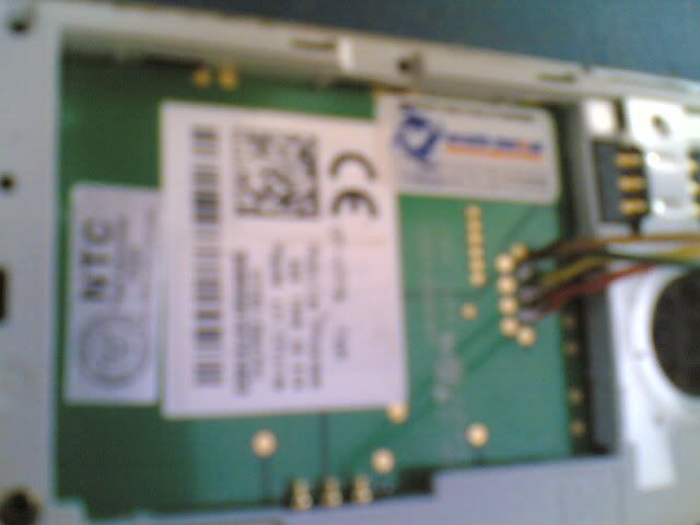

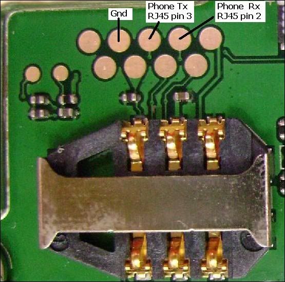

Ito po ang pin-outs.(nasa labas lang kaya madali lang isolder)
1.Connect pin out.

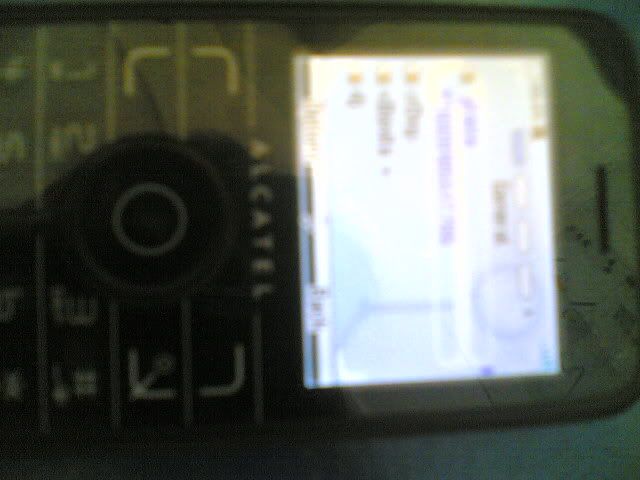

Format Done.
Test the Unit
