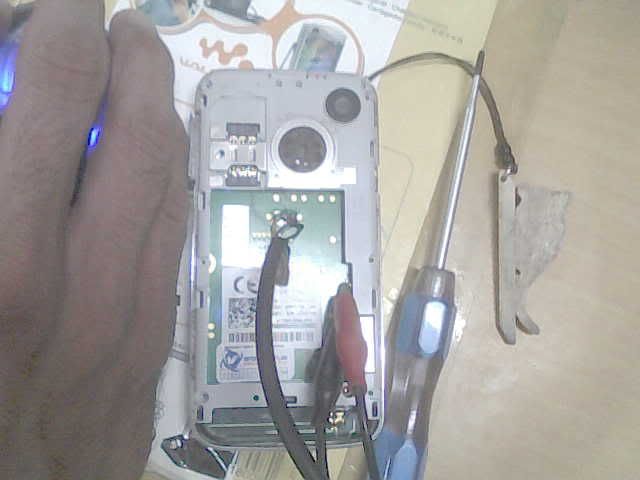

good evening mga bro share ko lang po ng konti...
unit: alcatel OT V770
problem: only logo then off.
action taken: full format in infinity box...

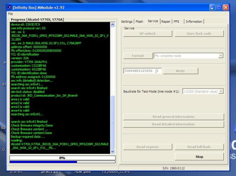

starting to format:
formating:
powering the units...
checking for signal:

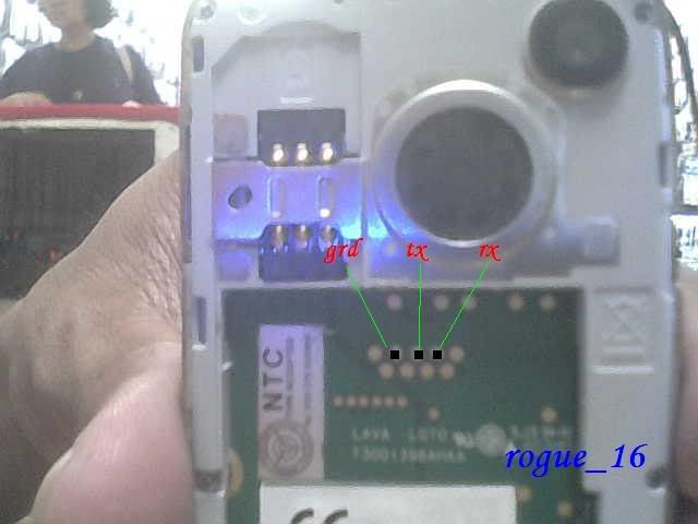

here is the pinout:
logs:
Code:
COM3 [VCP1] selected
module v2.92
Device: Alcatel-V770X, V770A
Checking data, wait...
advanced flash detection enabled
Action: "format ffs"
Do you want to make ffs/eeprom backup before format ?
ffs/eeprom backup enabled, it may takes several minutes !
Boot ...
Press and HOLD Power button now !
19200 fixed
Connecting, wait...
Initializing [6219:8B03:8B02]...
CPU: MT6219
detected CPU: MT6226MA
chip: 0031:2087:A000
status: 01
boot packet size: 0400
Release Power button now !
Boot Done
Initialize ...
detecting chip #00 in region #00...
flash: 01227E22302200:2BEA0000000000
flash: Amd AMD/Fujitsu std [D 0004x008000 00FEx020000 0004x008000] 32Mb
number of flash chip/regions detected: 01/01
Initialize Done
Set baud ...
115200
Set baud Done
Initialize bootcode ...
Initialize bootcode Done
Check firmware integrity ...
searching rom info...
search rom info finished
rom info structure: 2nd [enhanced] generation
TCL-ID is present
startup code area #1 is Ok
startup code area #1 backup saved: C:\Program  Files\InfinityBox\MModule\backup_security\id.2393D  7C9.[JRD26_06A_PCB01_GPRS_MT6226M_S02.MAUI_06A_W06_52_S  P1_V31.BIN_FF269AC7].rpl
rom info detection finished
TCL-ID detection...
TCL-ID detection done
device-id: 2393D7C9
rom info protocol ver: 05
ver. sw 1: JRD26_06A_PCB01_GPRS_MT6226M_S02.MAUI_06A_W06_52_S P1_V31.BIN
ver. sw 2: MAUI.06A.W06.52.SP1.V31, C79A26FF
address offset: 00000000
ffs offset/size: 01200000/00E00000
TCL-ID identification
version: 22A
provider: V770X-2AALPH1
customization: CG22BF66
customization: XG22BF66
TCL-ID identification done
ffs address assigned: 01200000
sec info (detailed) detection...
searching sec info#1...
search sec info#1 finished
sim-lock status: disabled
product id: JRD_Communication_Inc_SH_Branch
area1 is valid
area2 is valid
area3 is valid
area4 is valid
searching sec info#2...
Code:
search sec info#2 finished
Check firmware integrity Done
Check firmware content ...
Check firmware content Done
Backup required data ...
reading: Alcatel-V770X,V770A_JRD26_06A_PCB01_GPRS_MT6226M_S02.MAUI_ 06A_W06_52_SP1_V31__ffs...
file saved: C:\Program  Files\InfinityBox\MModule\Alcatel-V770X,V770A_JRD26_06A_PCB01_GPRS_MT6226M_S02.MAUI_  06A_W06_52_SP1_V31__ffs_20091213-172520.B0E.bin
original imei: 35965501013398
Backup required data Done
Patch required data ...
Patch required data Done
Special operation ...
Special operation Done
Write ...
Write Done
Finalization ...
ffs formatting...
Finalization Done
file saved: C:\Program  Files\InfinityBox\MModule\backup_security\Alcatel-V770X,V770A_JRD26_06A_PCB01_GPRS_MT6226M_S02.MAUI_  06A_W06_52_SP1_V31__system_log_2393D7C9_FF269AC7_2  0091213-172735.B0X.bin

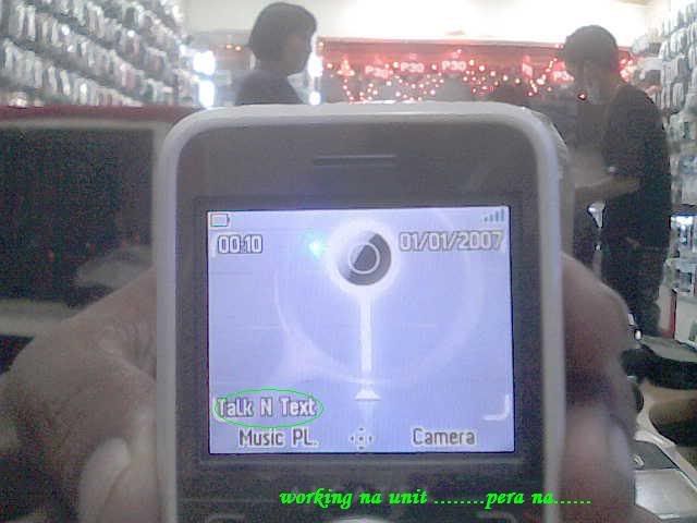

Finished, time used: 1682 sec
Remove/Install battery now !
File system has been modified !
It is need to press and HOLD phone "Power" button
during long time (up to 1 min) to make phone Powered-On !
