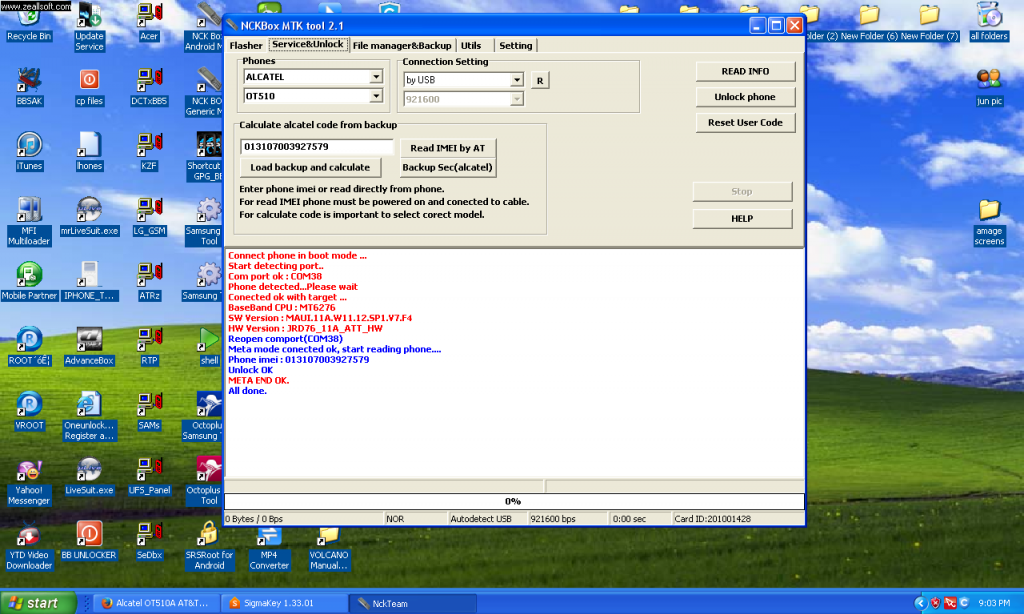

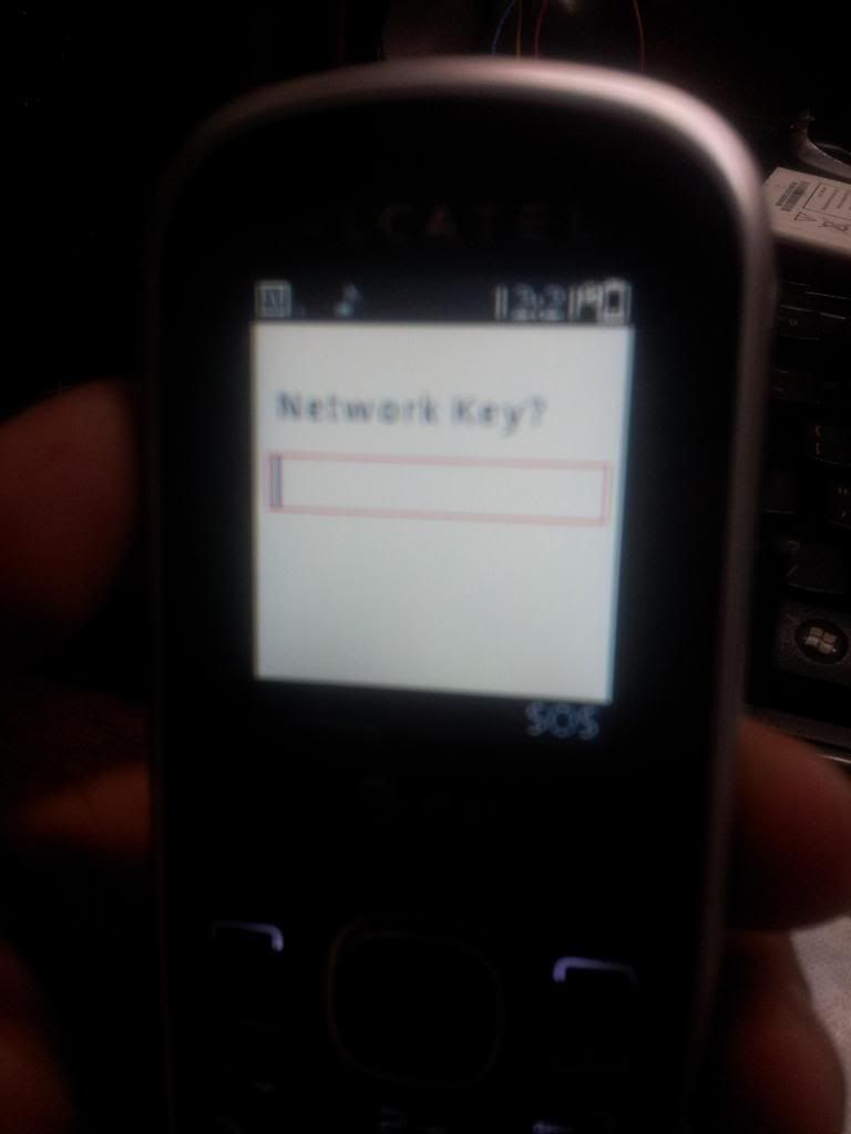

una ko pong ginawa unlocking gamit ang NCK BOX UNLOCK DONE NMAN po pero pag salpak ko naman ng sim na GLOBE Naghihinge po sya ng network key eto po sya....

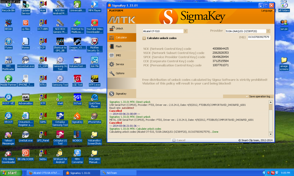

kya hanap ng ibang sulotion try ko po sa SIGMA BOX....
OPEN SIGMA BOX SET OT-510
SELECT PROVIDER KUNG SAAN SYA GLING UNG SAKIN KC AT&T KYA NILAGAY KO >>510A-2AAQUS1(XZ38YF20)<<
TPOS CLICK CALCULATE UNLOCK CODE WAIT UNTIL DONE...

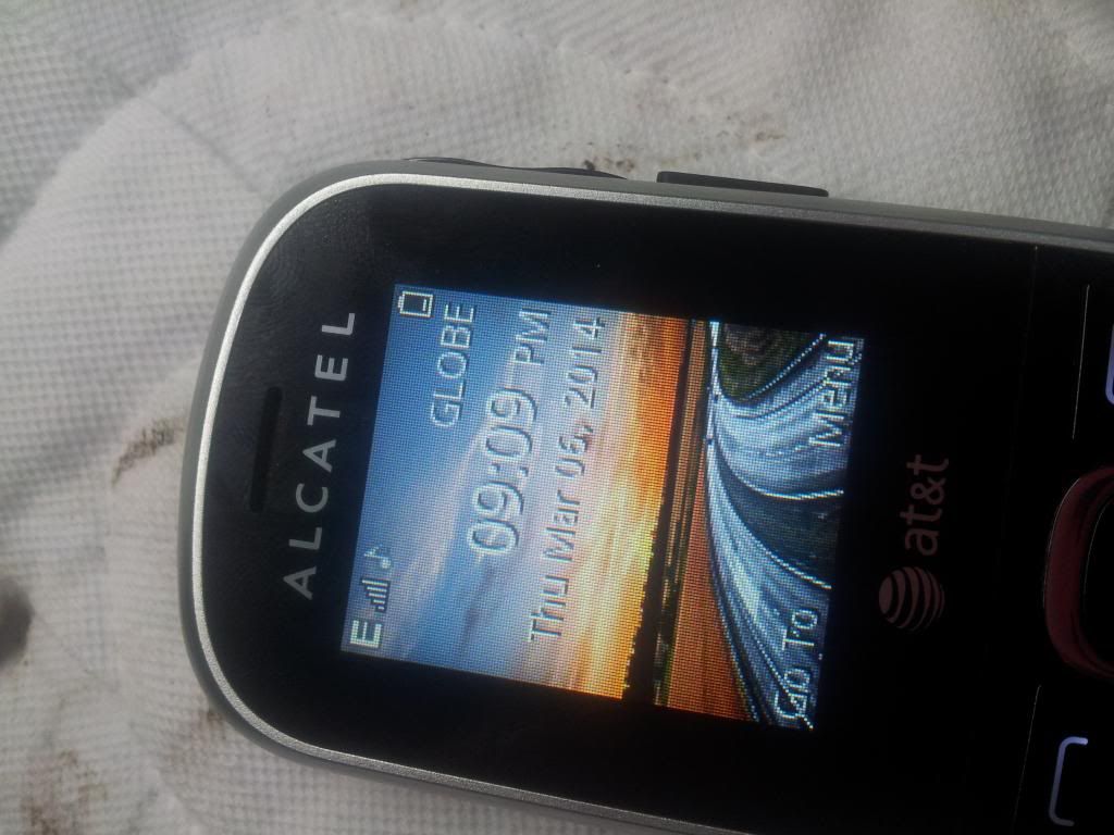

ETO NA PO DONE MGA AMO....
SI SIGMA LANG PALA ANG KATAPAT NYA...THANK'S ALL
