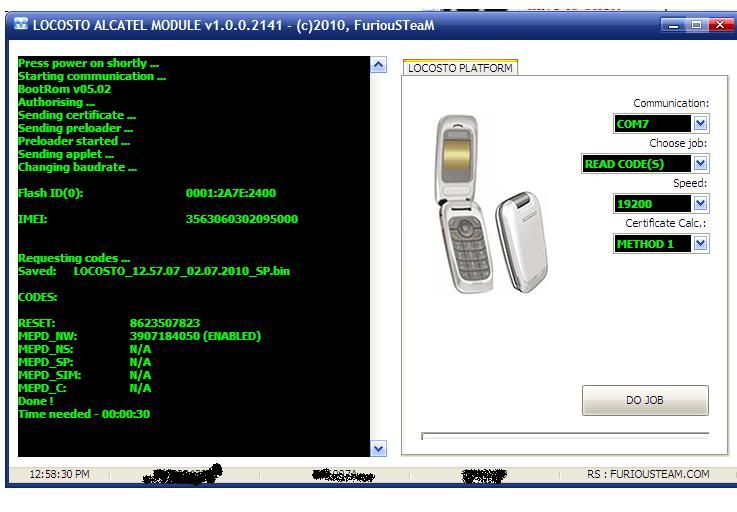

Click here to view the original image of 737x512px.

Procedure:
Update Firmware with pack # 3
Use VLECOSTO.exe "VLECOSTO_BETA_v1.0.0.2141" module
Select Correct Comport
Select Read Codes
Press Do JOb
After Reading Codes
Power On Phone
Insert Non Accepted Simcard
Enter Nck Code ...
