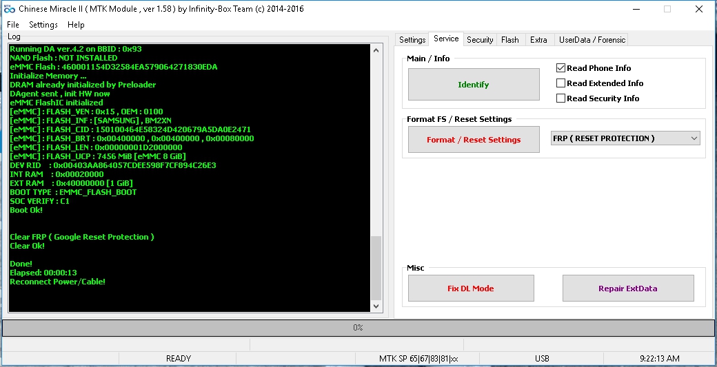

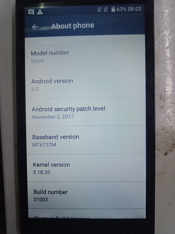

Alcatel U5 5044i FRP (Google Loc) done sa CM2MTK
open CM2MTK
select correct platform
select service tab
click format/reset settings
insert usb to unit (off)
done na po
