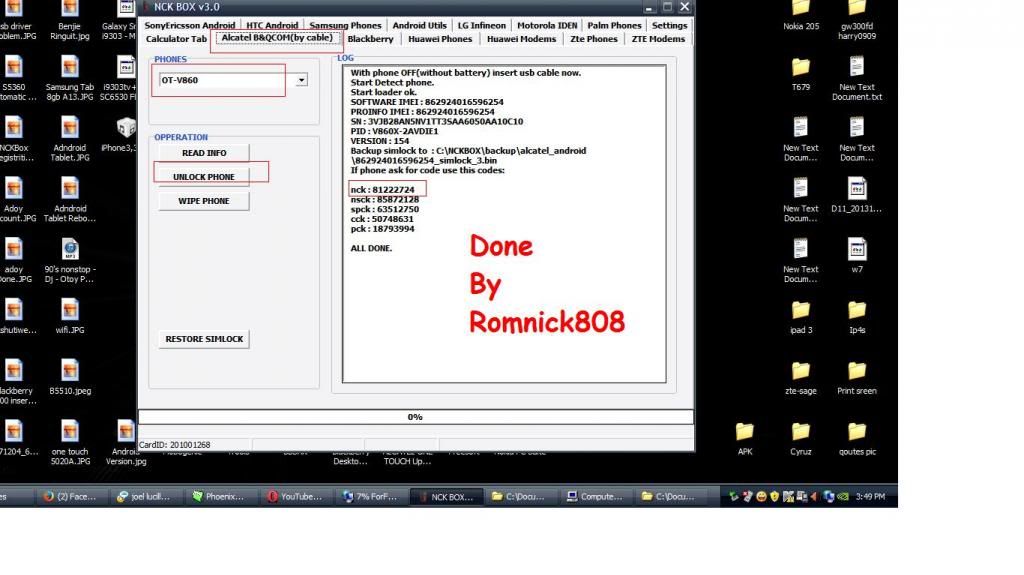

Procedure:
Connect NCK Box To PC
Open Icon NCK & Click Alcatel B&QCOM(by Cable)
Select Phone Model OT-V860
Power On The Phone & Connect USB The Phone
Install Driver If Needed
Click Read Info or Direck Unlock
With phone OFF(without battery) insert usb cable now.
Start Detect phone.
Start loader ok.
SOFTWARE IMEI : 862924016596254
PROINFO IMEI : 862924016596254
SN : 3VJB28AN5NV1TT3SAA6050AA10C10
PID : V860X-2AVDIE1
VERSION : 154
Backup simlock to : C:\NCKBOX\backup\alcatel_android\862924016596254_simlock_3.bin
If phone ask for code use this codes:
nck : 81222724
nsck : 85872128
spck : 63512750
cck : 50748631
pck : 18793994
ALL DONE.
