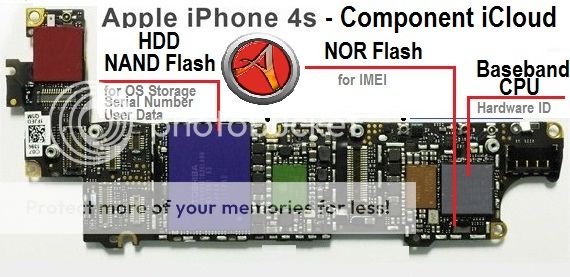

iPhone 4s Memory Management
-HDD NAND Flash (For OS Storage Serial Number User Data
-NOR Flash (For IMEI)
-Baseband CPU (Hardware ID)

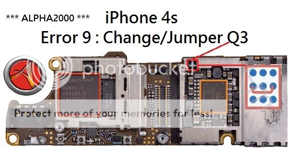

iPhone 4s Error 9
-Jumper Q3

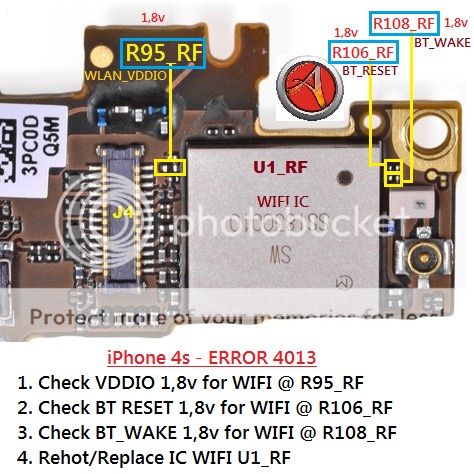

iPhone 4S Error 4013
-Check VDDIO 1.8v for WIFI @ R95_RF
-Check BT RESET 1.8v for WIFI @ R106_RF
-Check BT_Wake 1.8v for WIFI @ R108_RF
-Rehot/Replace IC WIFI U1_RF

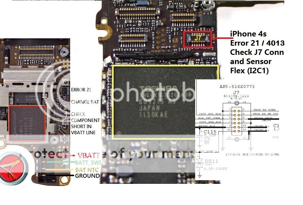

iPhone 4S Error 21
-Changed Batt
-Check component short in VBATT line
-Check J7 Connector and sensor flex I2C1
