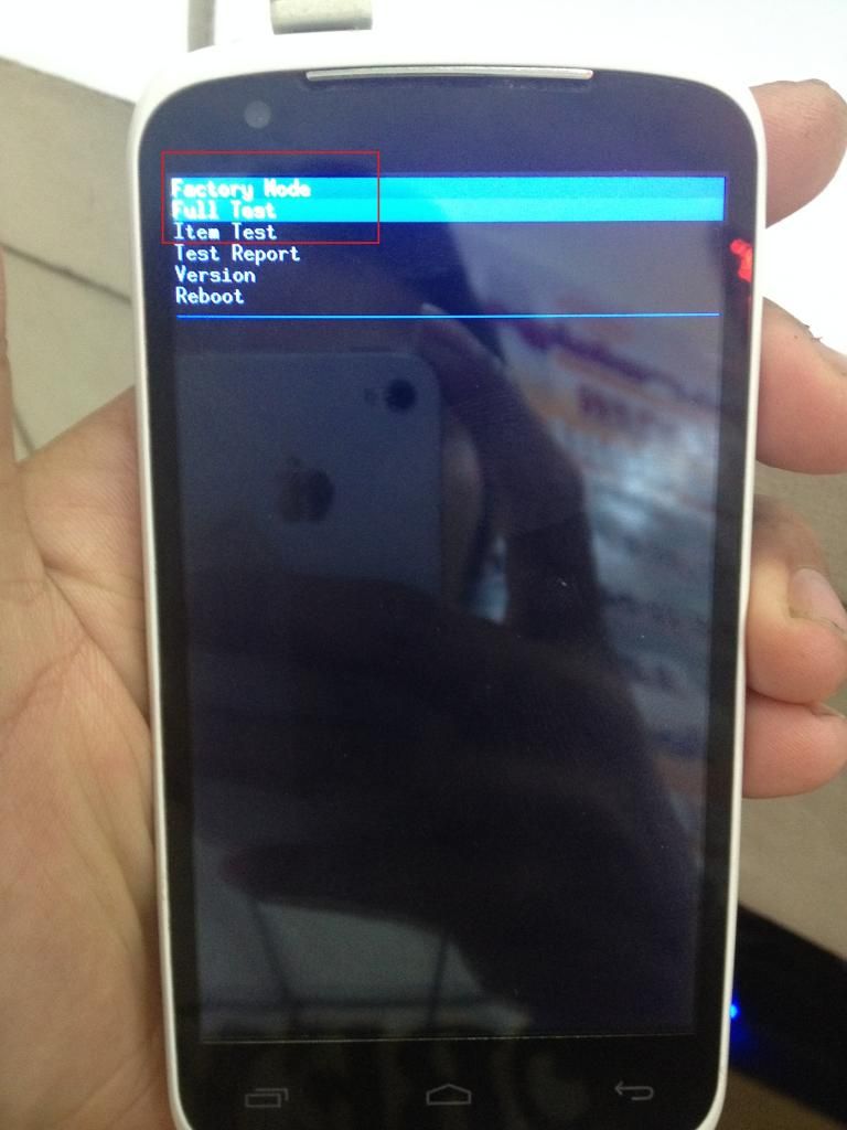

PROCEDURE

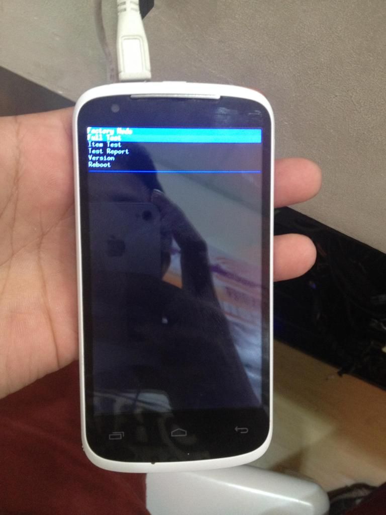

FIRST STEP
OFF UNIT DIN HOLD VOLUME BUTTON KUNG SAAN PO SYA MAY FACTORY TEST......DIN INSERT USB CABLE..
FACTORY TEST
FULL TEST
ITEAM TEST
VERSION
REBOOT
2ND STEP

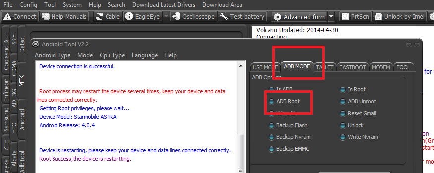

ROOT PHONE
OPEN SOFTWARE VOLCANO OR VROOT...
ADB ROOT
DIN HOLD LANG PO ANG VOLUME UP OR DOWN KUNG SAAN MO SYA NAKUHA CONBINATION BUTTON PARA KAY FACTORY TEST...
AFTER ROOT DEVICE IS ROOBOTING... ==VOLUME HOLD AGAIN ..PARA PUMASOK PARIN KAU SA FACTORY TEST.....

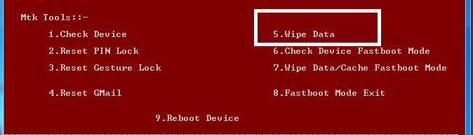

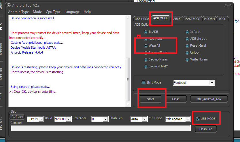

3rd step
WIPE ALL DATA DONE
NOTE:SA MGA WALANG VOLCANO
