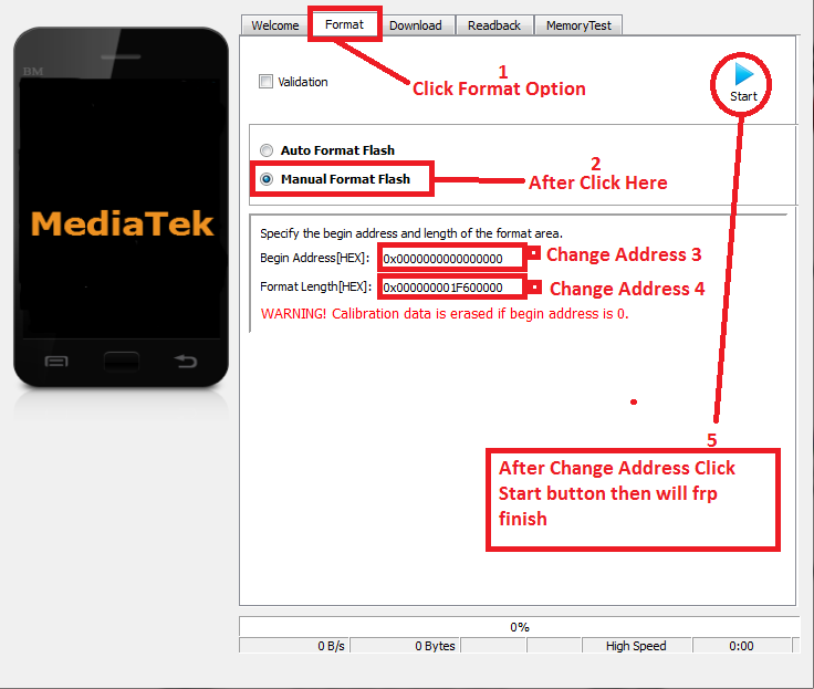

Support ALL MTK 6737T MediaTek CPU Android 6.0.1 7.0 You can Bypass With SPTooL
Bypass Frp Mtk Devices Using SPTooL
Make Sure You having Same flash file for that same mobile open sptool and select that scatter file
and go to format option
now copy and paste that specific format lenght codes that i have given down make sure u have 30% battery charged
FOR ALL MTK 6737T MediaTek CPU Android 6.0.1 7.0
Begin Address[HEX]:0x6a00000
Format Length[HEX]:0x100000
or
Begin Address[HEX]:0x6a000000
Format Length[HEX]:0x1000000
