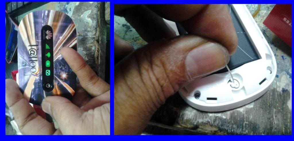

Step 1
Power On/Reset Button/tangal battery tapos balik/power on
(lahat po ng pocket wifi my reset)

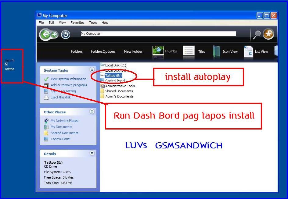

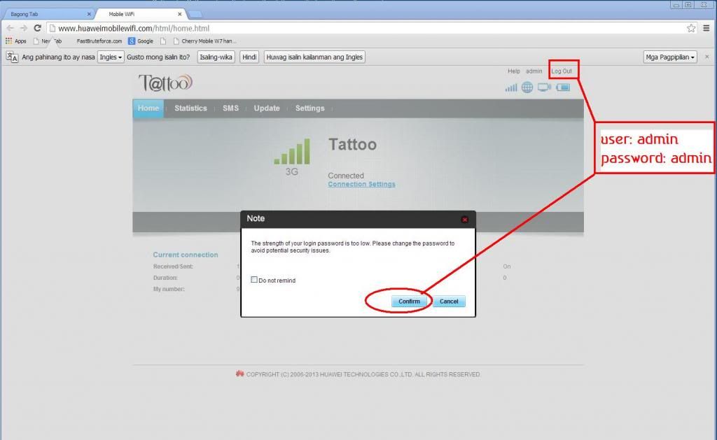

Connect usb to pc install lang po ang set up Auto Play
Click Run Dashbord
Step 3
Note: disconect muna internet conection na gamit
nyo bago nyo open DasH Bord
Step 4

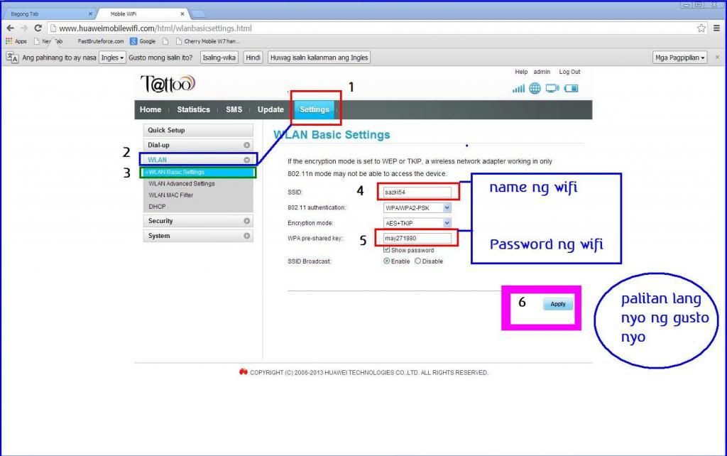

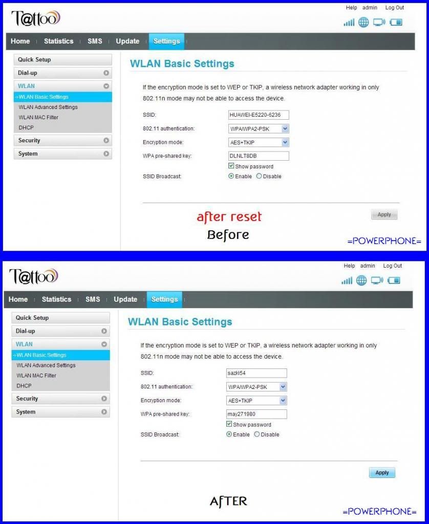

Setting /Wlan/Wlan Basic Setting
SSID -Name na gusto nyo sa wifi
Wpa Pre-Shared Key -Password ng wifi
<aside>
Pag napalitan na po nyo Click /Apply/ tangal balik baterry /power on ​​
</aside>

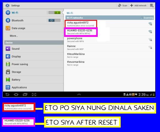

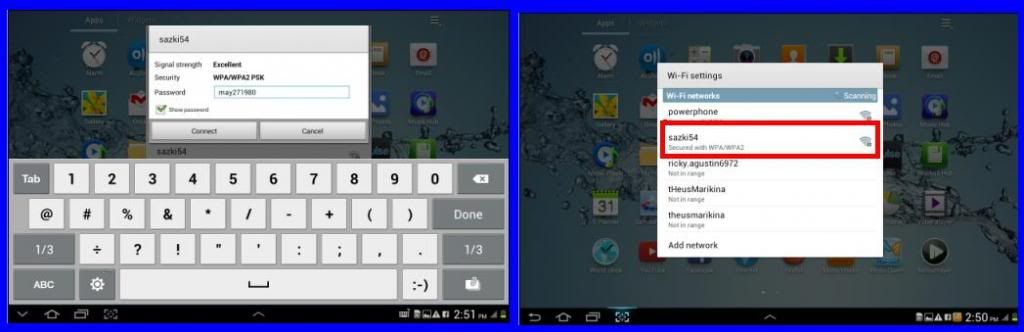

Before and After
Test and Connect
DONE
