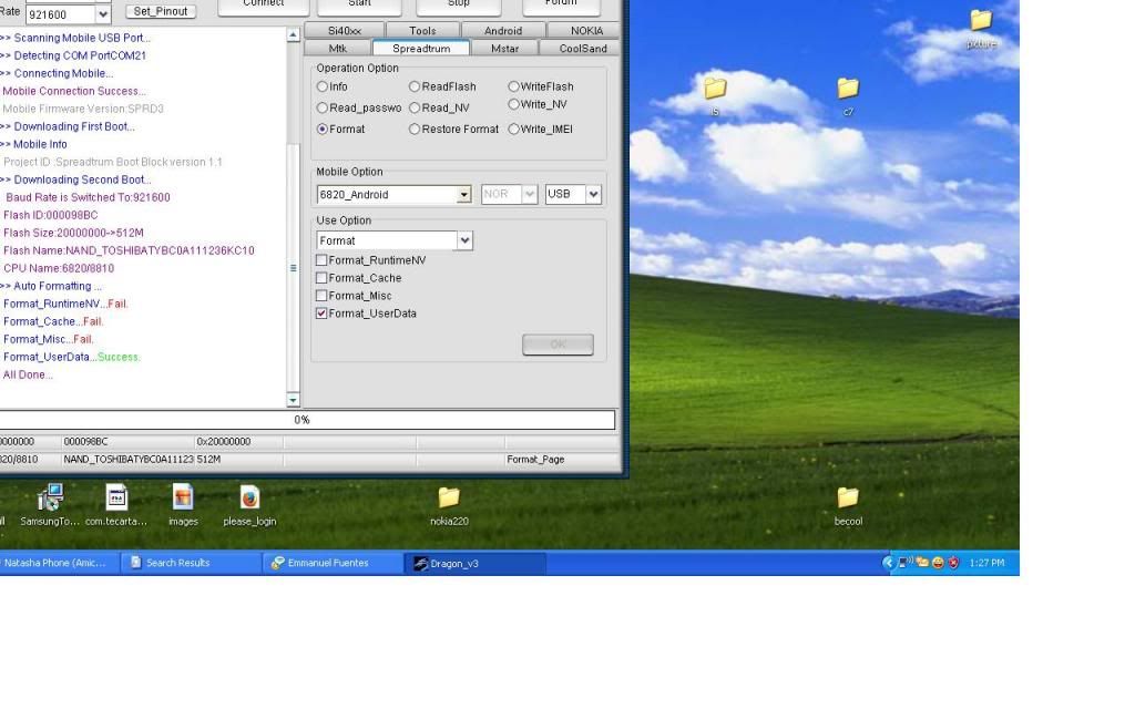

Amicom ELAN2 pattern done..[Reference]
na try sa ko hr pero ayaw . kaya try ko naman kay gpg ayos sapul...
Tools:
- GPG Dragon Box
- p-07a-cable
(note) format data lang naka check
GPG ..ver.3,46
Project ID :Spreadtrum Boot Block version 1.1
>>> Downloading Second Boot...
Baud Rate is Switched To:921600
Flash ID:000098BC
Flash Size:20000000->512M
Flash Name:NAND_TOSHIBATYBC0A111236KC10
CPU Name:6820/8810
>>> Auto Formatting ...
Format_RuntimeNV...Fail.
Format_Cache...Fail.
Format_Misc...Fail.
Format_UserData...Success.
All Done...
