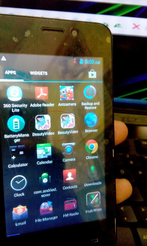

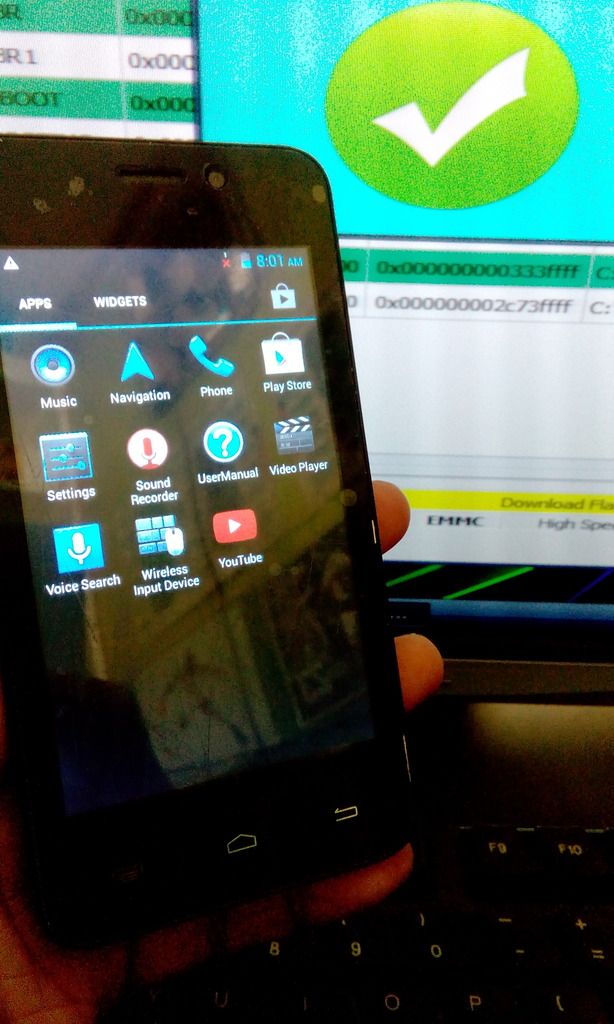

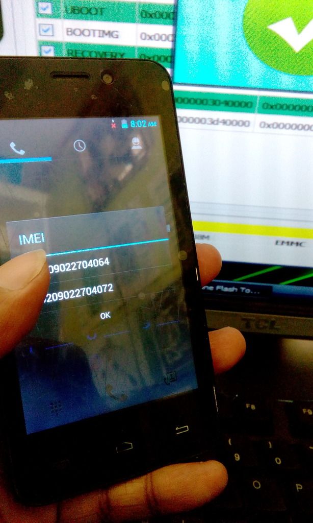

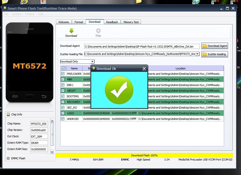

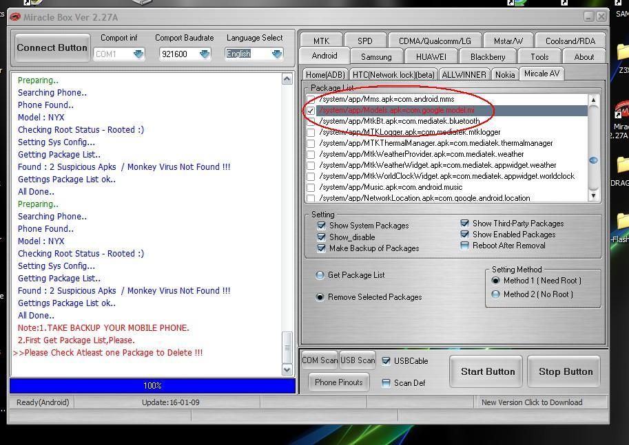

AMICOM NYX makulit na model virus done via spflash!
1st..
scan via miracle crack..
then remove..all done..
pero bumabalik balik parin si model virus..

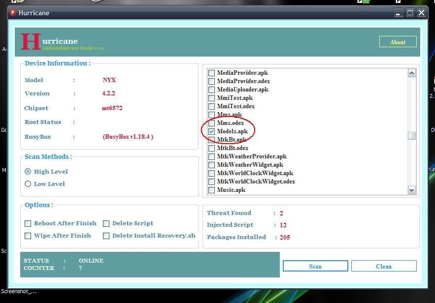

2nd..
scan via Hurricane anti malware..
pero makulit talaga si model virus
last choice flashing kaya use search button sa ating tahanan..
tnx sa usefull post ni sir 1_dRick_tion
http://antgsm.com/showthread.php?t=64522&highlight=amicom
DONE!!

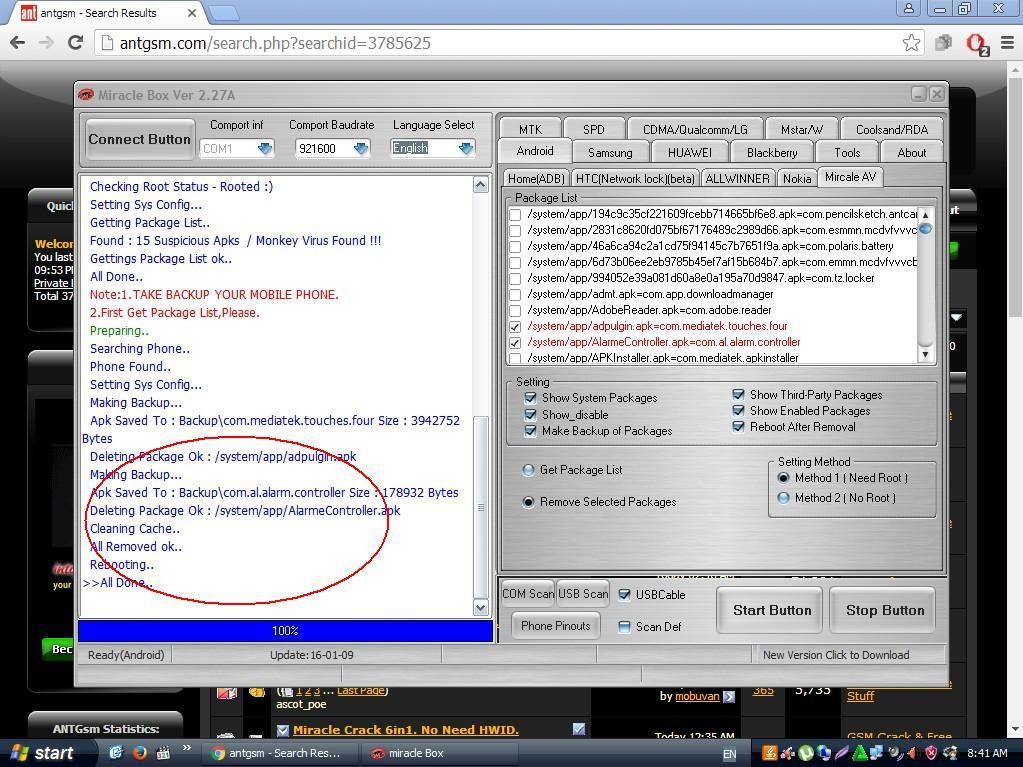

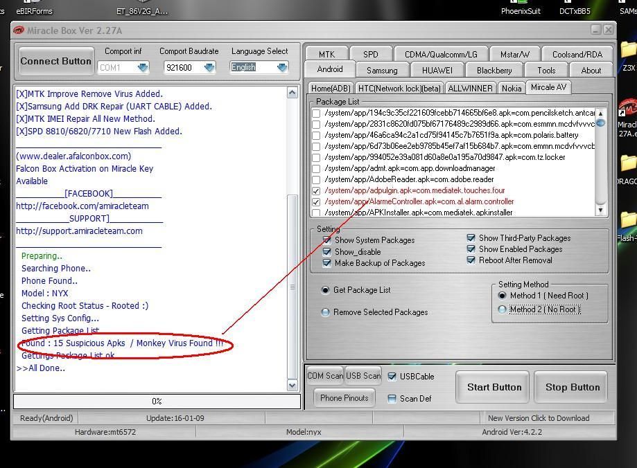

1st..

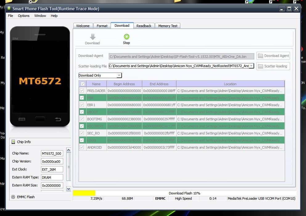

DONE!!
