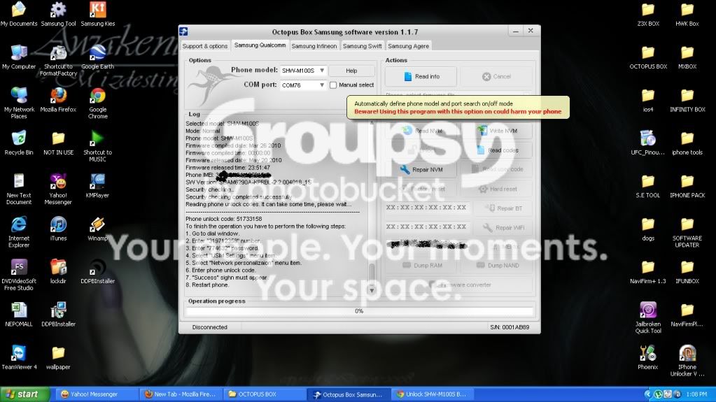

Press "Read Info" in Octopus Samsung software
eto po logs
Selected port: COM76
Selected model: SHW-M100S
Mode: Normal
Phone model: SHW-M100S
Firmware compiled date: Mar 26 2010
Firmware compiled time: 00:00:00
Firmware released date: May 20 2010
Firmware released time: 23:51:47
Phone IMEI:
SW Version: SBAM6290A-KPRBL-2.2.004018_1S
Security checking...
Security checking completed successfully
Reading phone unlock codes. It can take some time, please wait...
Phone unlock code: 51733158
To finish the operation you have to perform the following steps:
1. Go to dial window.
2. Enter "319712358" number.
3. Enter "774632" password.
4. Select "USIM Settings" menu item.
5. Select "Network personalizaion" menu item.
6. Enter phone unlock code.
7. "Success" sighn must appear.
8. Restart phone.
eto po screen shot

follow nalang po ung prcedure pag tapus mag read ung codes
