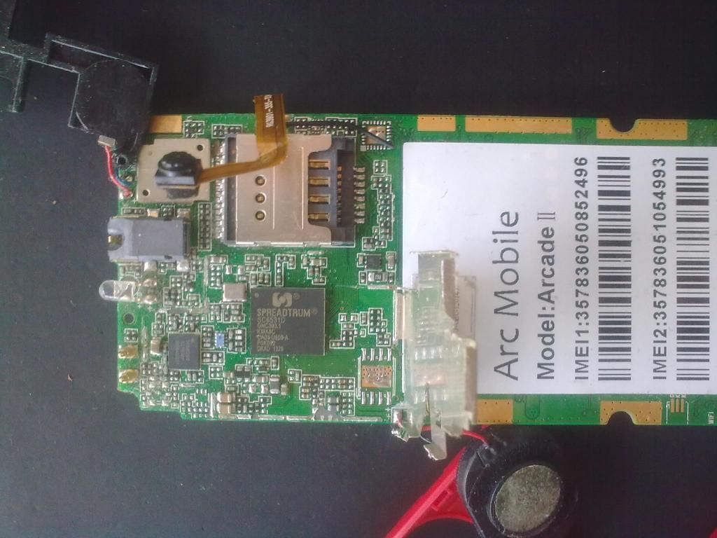

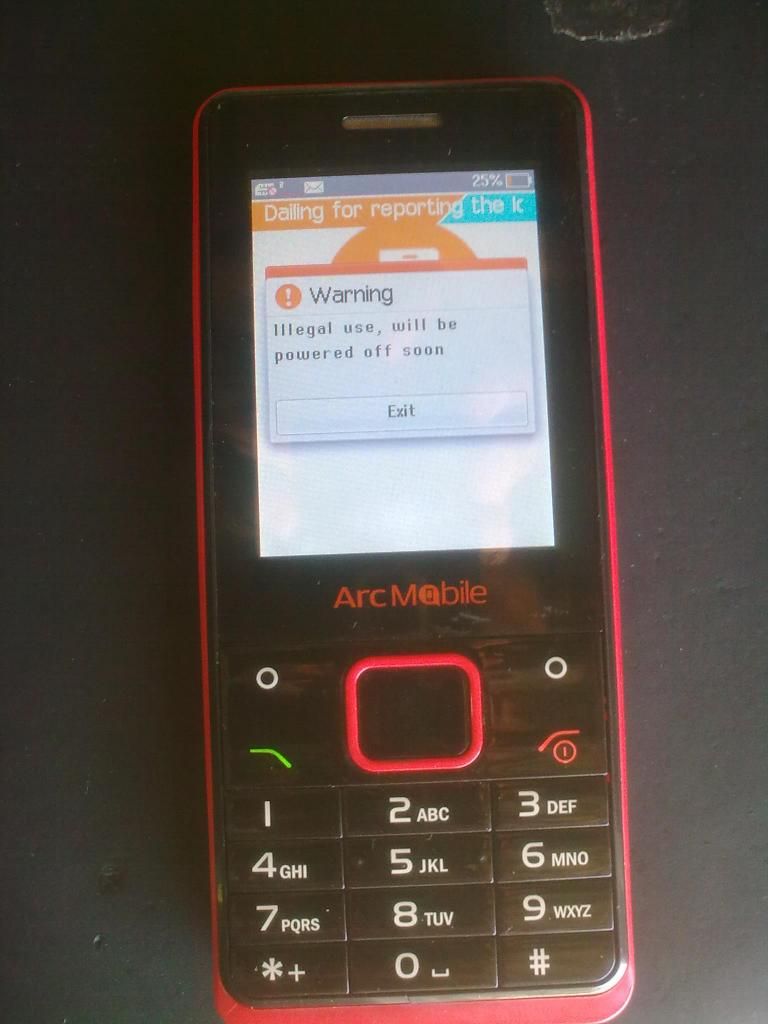

PROBLEM:
Illegal Use,Will Be Powered Off Soon (If Sim Card Inserted)

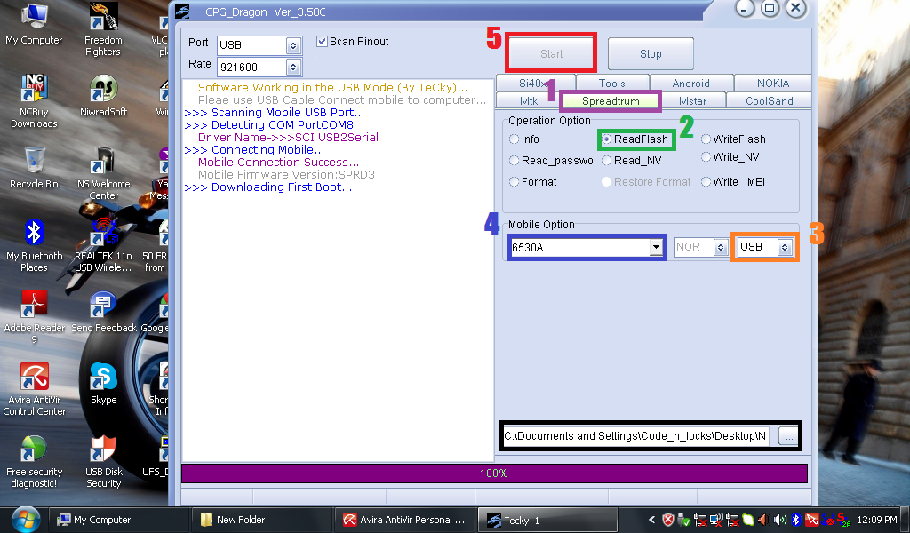

PROCEDURE:
Disable Your Antivirus
Open Dragon By TeCkY 1.1
1.Tick Spreadtrum
2.Tick Read Flash
3.Tick Com To Usb
4.Tick Mobile Option (Set To 6531A)
5.Tick Start & Insert Micro Usb (Install Driver If Needed)Wait Until Done...

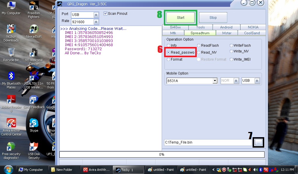

TO READ SECURITY CODE:
6.Tick Password
7.Your Files Back Up
8.Tick Start & Wait Until Done...

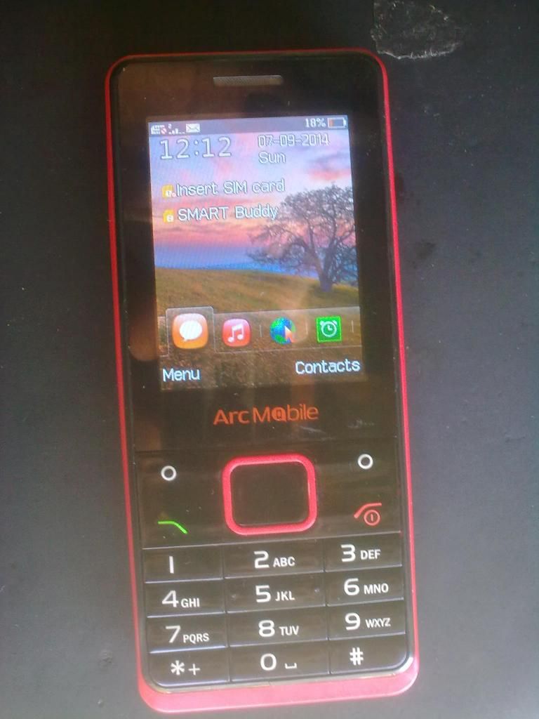

FINISHED PRODUCTS:
illegal use po ba problem sir? bakit parang niread flash mo lang at niread password mo lang ok n po hnd na sya illegal use?
pacnsya na po nililinaw ko lang hindi ko po kc magets....slmt
Yap!!! tama ka sir ni read ko sya para ma read ang security code o password para ma restore...kasi ang poblema po pag may sim sir nag e-ellegal use power off take note sir...:)) pag may sim card pag wala po ok naman sya kaya read flash ginawa ko para mas madaling marestory factory setting at safe pa...:D
