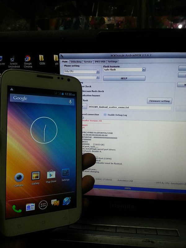

[STOCKROM_V004] SP Flash Tool Procedure for Arc Mobile MEMO
What's needed:
PC / LAPTOP (32-bit much better)
Stockrom
USB data cable
MediaTek USB VCOM drivers
SP Flash Tool (Any Version Will Work)
Download Link:
http://goo.gl/1Eynh4
Edit:
added download link only
-eo
HOW TO FLASH:
Download, Extract, and Install Drivers to PC
Open SP Flashtool
Select 'Android Scatter file' inside ROM folder (MT6589_Android_scatter_emmc.txt).
Now Turn-Off your Phone and Remove the BATTERY.
Click Download Button.
Connect Your Phone (Switched Off) to PC via USB Cable and put back your battery.
If everythings right, Flashing will proceed..
When the yellow bar is complete, you'll get a popup with a green circle and Download OK message, which means that the process has been successfully terminated.
Now Close SP Flashtool.. Remove Phone from PC..
Switch ON the phone...It is successfully Flashed
