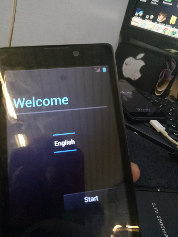

GOOD DAY MGA KA ANT SHARE KO LANG TONG GAWA KO(ARC MOBILE NITRO 501D)
DALA NI TUMER HANG LOGO,BACK UP KO MUNA PARA IWAS ABERYA TRY KO RESET USING NCK BUT NO LUCK
KAYA HANAP FW BUTI NA LANG DI AKO NABIGO,PROCEED NA SA FLASHING,
AFTER FLASH TULALA PA RIN MGA BOSS KULANG KASI FW WALANG CACHE /USRDATA
FLASH KO ULIT COPY KO CACHE/USRDATA GALING SA BACK UP KO,
AFTER FLASH BOOM SAPOL TUMINO DIN ITO NA CYA
BACK UP KO ULIT ITO NA COMPLETE FW NYAhttp://www.mediafire.com/file/cofvlqvs8vxi5mi/arc_mobile_nitro_501D.rar
