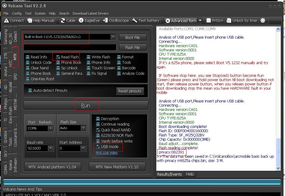

arcmobile model:basic privacy code! DONE
unit : arcmobile
model: basic
problem: privacy locked
tools
volcano box
usb cable (motorola v3 type/ mp5 usb)
action taken
readflash by volcano
problem encounter
1.can't detect using jig
2.no pinout found in board
but when i power on phone and connect usb...it is detected and i found that is has mtk chips
Procedure
1. connect volcano box
2. open volcano software
3. go to mtk tab directly
4. set boot file to v5.1232 635a/62xx
5. check read flash
6. uncheck auto-detect pinouts
7. check usb mode
8. thick run
when software says " analysis of usb port, please insert phone usb cable
with phone power off and with battery
insert usb cable to phone then press power on shortly
and wait for detection
wait reading flash to finish
DONE!
screen shot
back up with code 082391
arcmobile basic back up with privacy mt625a chips - Download - 4shared
for reference only
