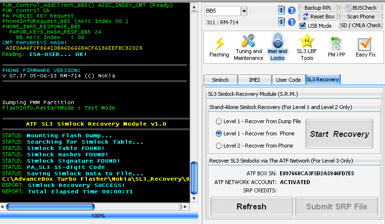

Pagka swerte swerte naman nitong asha na ito at naka kuha ng simlock recovery.
Procedure:

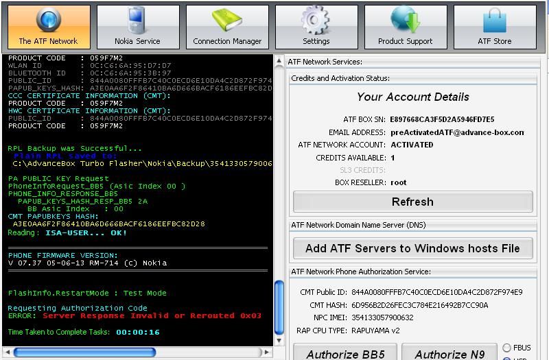

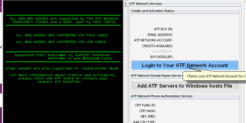

Open ATF
Log in ATF network
Go to IMEI ANG LOCKS tab

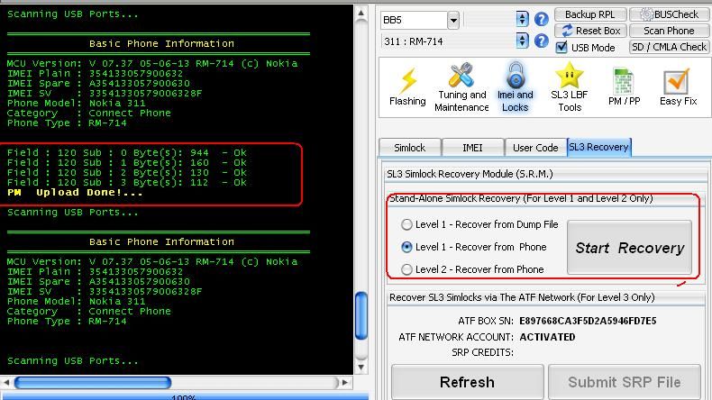

click SL3 recovery
click server 1 recover
click start
wait until suaccessful
Punta naman tayo sa pm Tab
check write full pm
at ibrows sa loob ng folder atf/ hanapin ang recovery folder select pm file
done..
may error kulutan lang
ok solved
