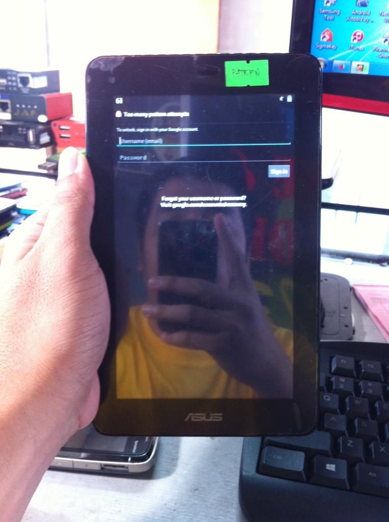

UNIT: ASUS MEMO PAD
PROBLEM: TOO MANY PATTERN ATTEMPT

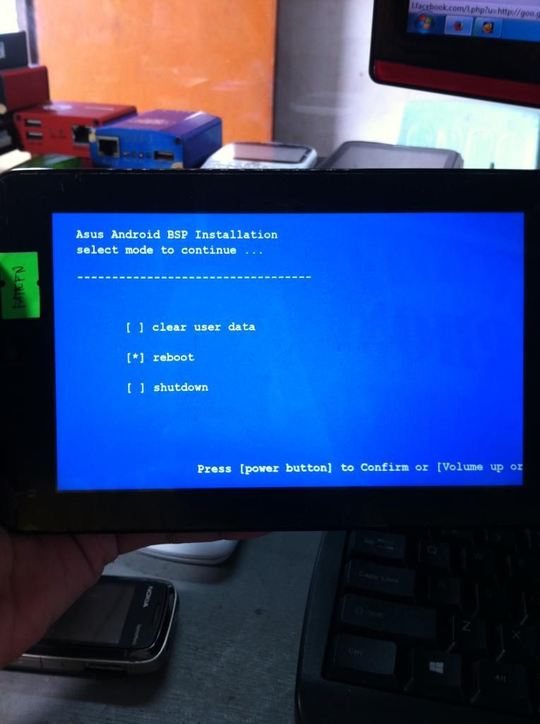

TOOLS: 2gb micro Sd card & CLEAR data zip
http://www.4shared.com/zip/fuoYN9raba/ASUS_MEMO_PAD_cleardata.html?
PROCEDURE:Format sd card,at e extract dun ang clear data file,e off lang po ang unit,salpak ang sd card at e on automatic lalabas nlang po ito,at sundan nlang ang nasa screen ng tab..

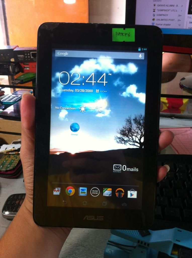

done na po..good day po sa lahat god bless
