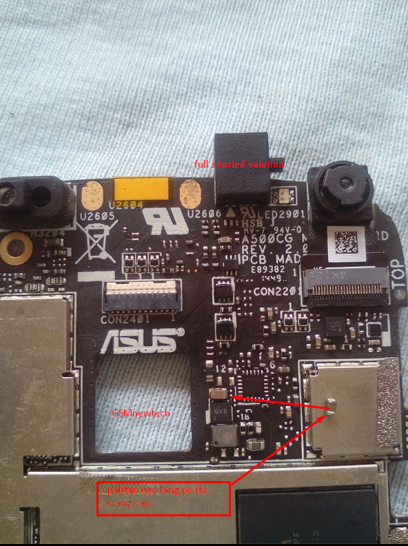

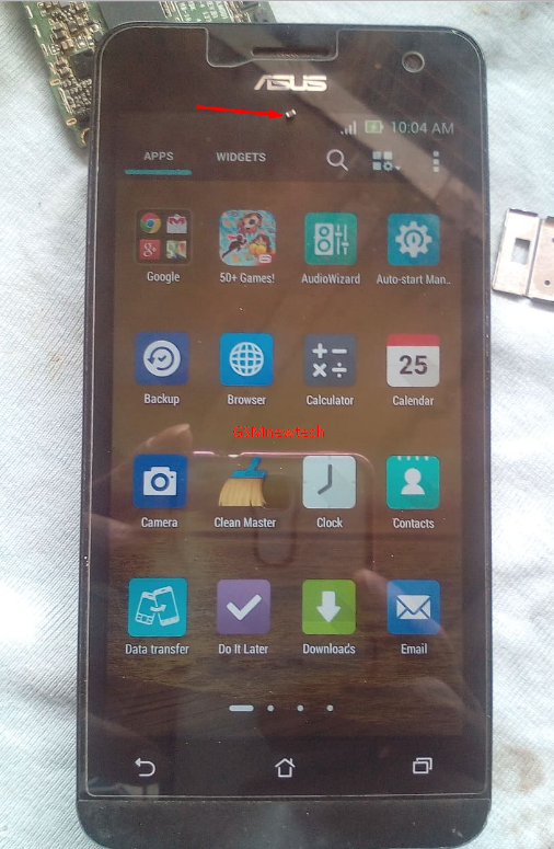

jhun1308 Registered Joined Jun 11, 2016 Messages 285 Reaction score 116 Points 1 Location naga city Jan 28, 2019 #1 asus t00j d dead full shorted solution bigla nalang daw namatay check ko tester full shorted hanap ang salarin kng bkit namatay eto pala palitan lang po isang cap. matapos mapalitan buhay na pera na 600 petot din FOR REFERENCE ONLY Last edited by a moderator: Dec 11, 2020
