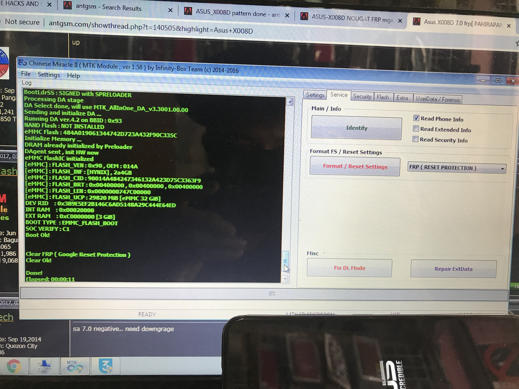

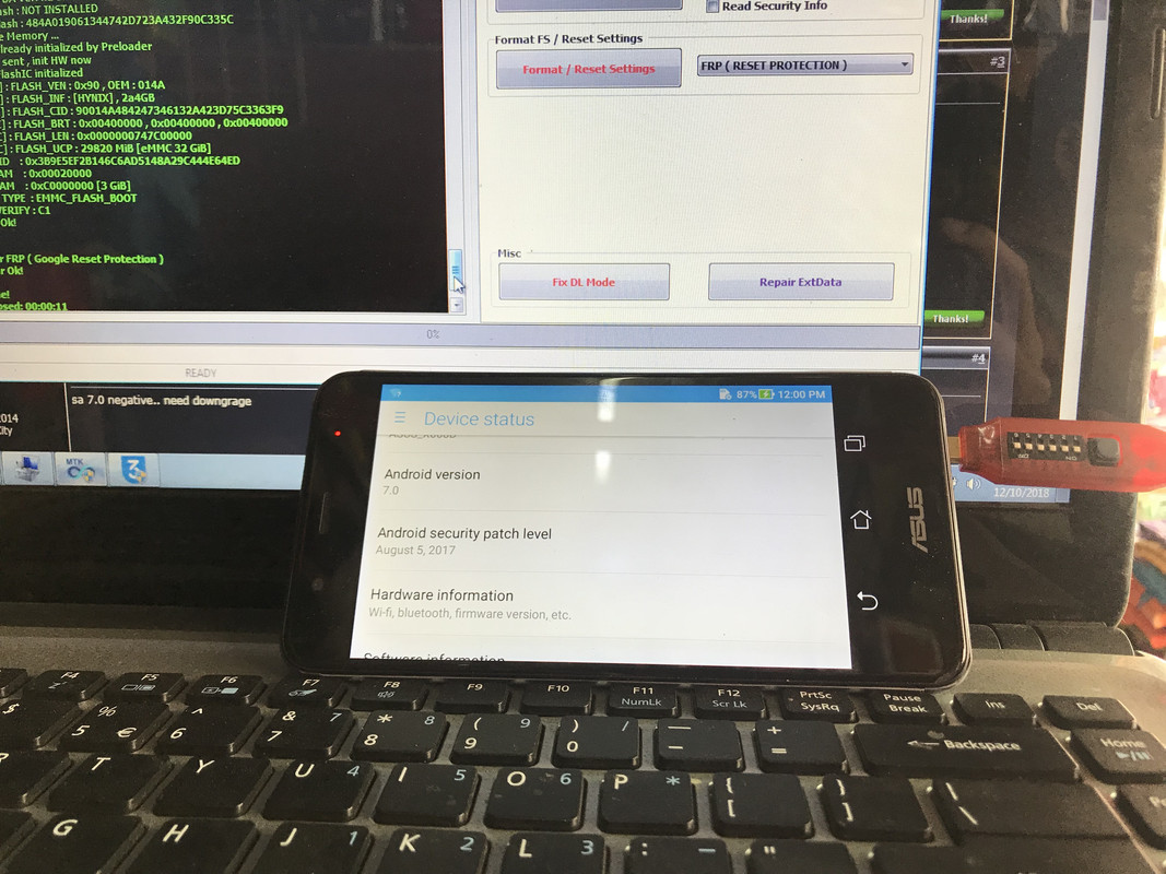

For removing pattern and frp
Tools Needed: CM2t, multiboot USB cable
No Need Internet
1. open cm2
2. click fomat/reset setting (FRP reset protection)
3. turn off unit
4. Insert multiboolt Mircro USB cable
5. boom
6.singil na kay tomer
7.DONE!!
