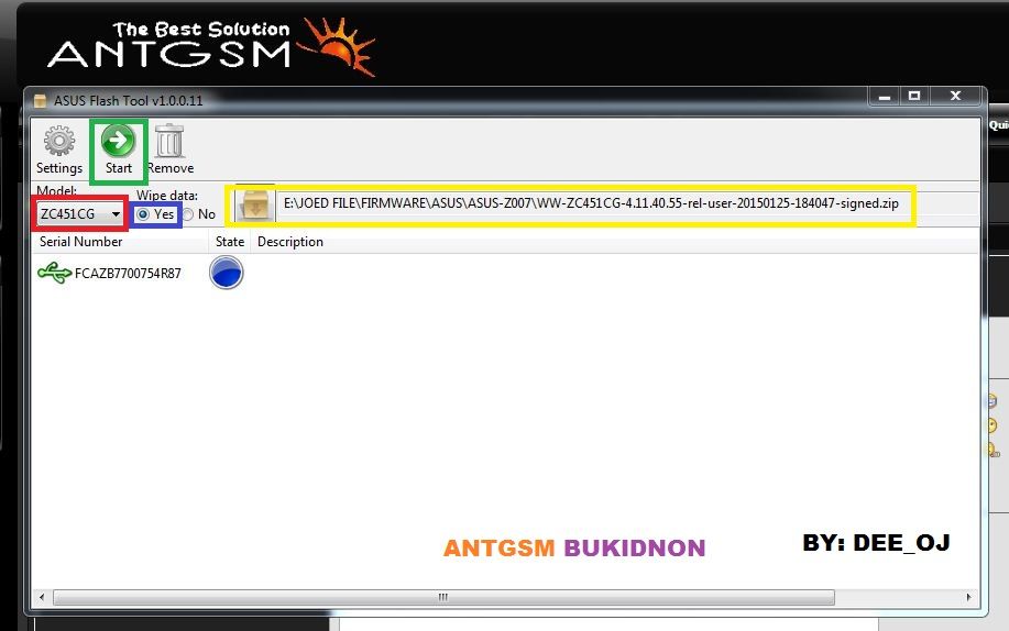

ASUS Z007 -HANG ON LOGO -DONE!!!!
FIRMWARE LINK: https://drive.google.com/file/d/0B__oiYlSY-brdHFWMy1OWXNrajg/view
-NOTE: NO NEED TO XTRACT THE FIRMWARE
STEPS:
1-SELECT MODEL (PILIIN MO LANG YUNG NASA SCREEN SHOT)
2-CHECK 'YES'
3-LOAD FIRMWARE
4-CLICK START

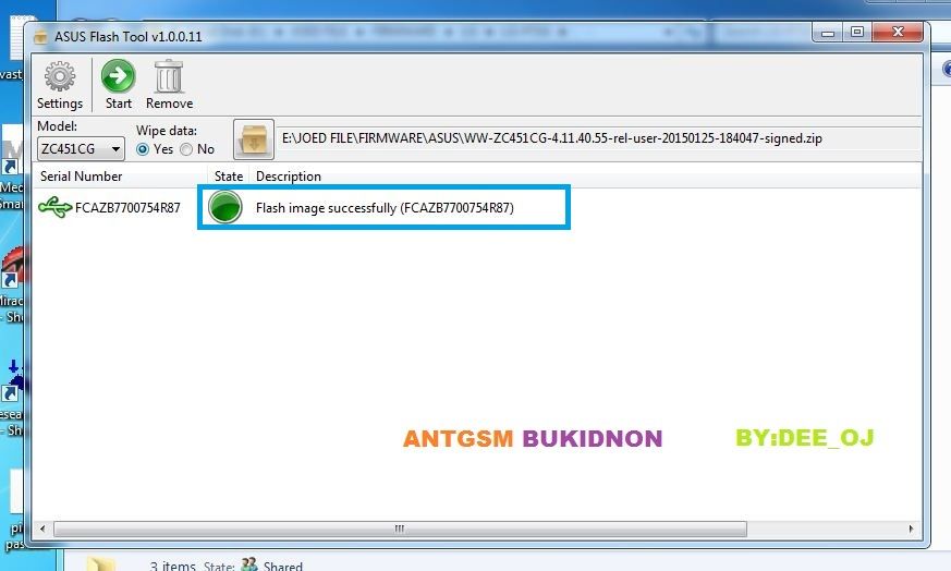

5-WAIT UNTIL ITS DONE!!!!!!
WAITING.................(WAG LANG MA INIP,,,ANTAY-ANTAY DIN PAG MAY TIME,,,, :D:D:D:D:D

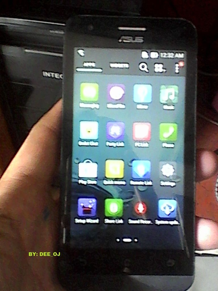

DONE!!!!
FINISH

tested po sir firmware kaso bakit po kya after flashing ayaw magcharge cp pero pag sinaksak sa charger nag vibrate naman tapos detected padin nmn sa pc yung cp wla lang sign ng charging
note charging ok po ito bago ireprogram eh nafulcharge pokasi muna bago isalang
tnx po
tnx p
nag chcharge yan boss,,, pag nka off ang unit,,,
pki usapan mo nlng c tumer =,, ganyan din kasi nangyari sakin,,,:-bd:-bd:-bd:-bd
kasi pag ina update kasi ulit,, back to hang logo boss,,
