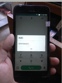

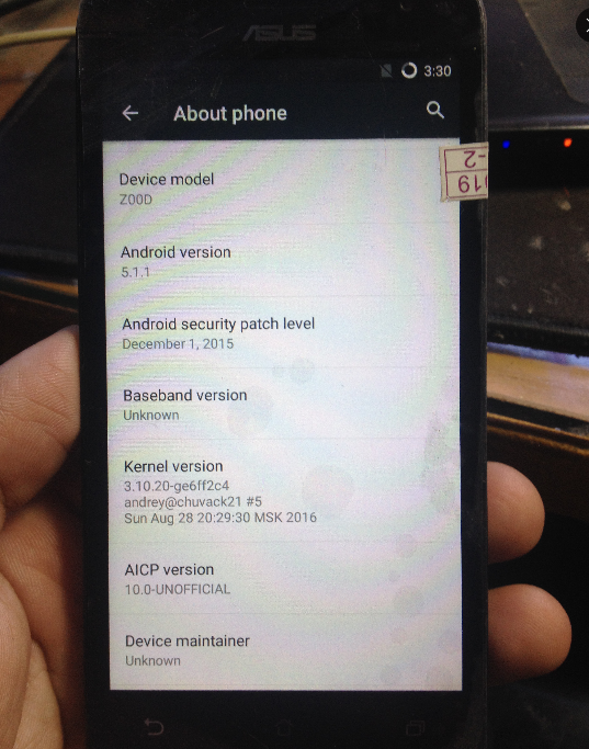

history no imei at unknown baseband pinagawa na rin sa iba pero sinukuan
at naka twrp narin,,,titigan po mabuti kung magka same info tau yariin mo na
solution,,update via sd card download mo to hold volume up at power buti naka twrp narin
mas madali nxa eupdate via sd card,kung dipa naka twrp search nyo nlng po ke google
o kaya update via adb sideload mode
dlcdnet.asus.com/pub/ASUS/ZenFone/ZE500CL/UL-ASUS_Z00D-WW-12.16.4.3-user.zip?_ga=1.206081040.2085141254.1461933350

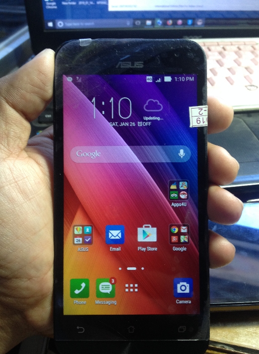

after update ito na po siya,,,,kaya lng di pa openline,,pero madali nlng

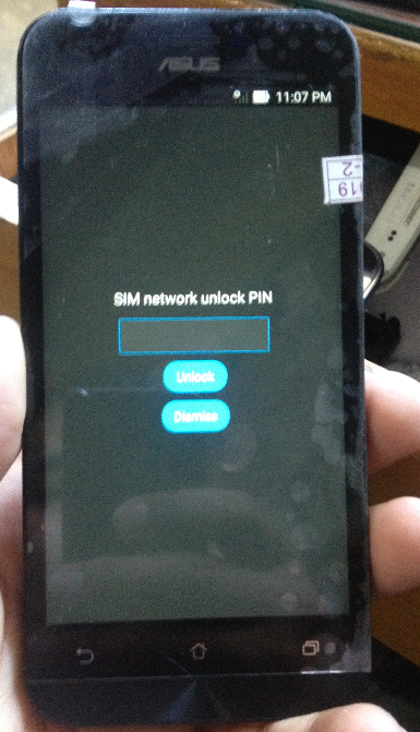

para maunlock nman ito solution dapat naka usb debug

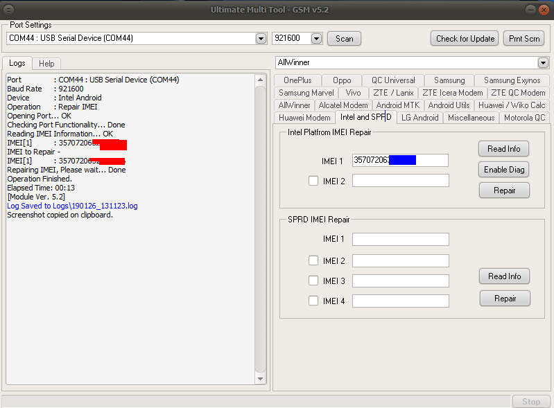

1.root first search nyo nlng kung panu siya eroot
2.open umt gsm
3.select intel and sprd,enter nyo lng po imei nya same
4.press enable diag,after that press scan sa port nya
5.lastly press repair,,,,pera na yan
