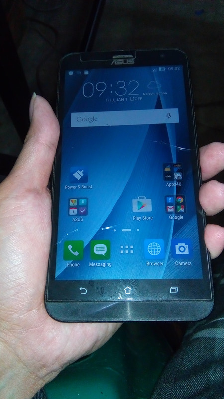

problem:​
logo hang, sinubukan ko sa hard reset gumana pero nag a-auto restart​

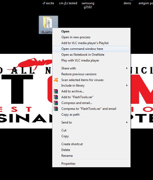

pagkatapos i extract,mula sa asus folder icopy ang tatlong files na to sa flashtool folder​
-boot.img
-recovery.img
-system.img
under flashtool folder press "shift + right click" then click "open command window here"​

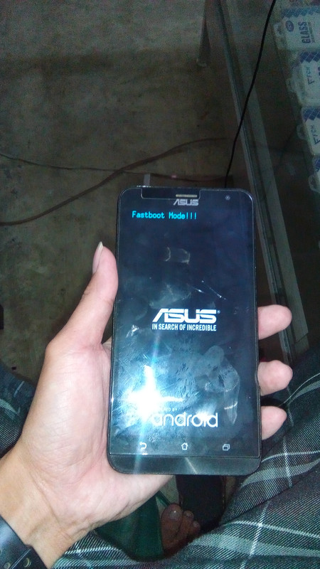

iset ang phone via fastboot (press volume down at power)​

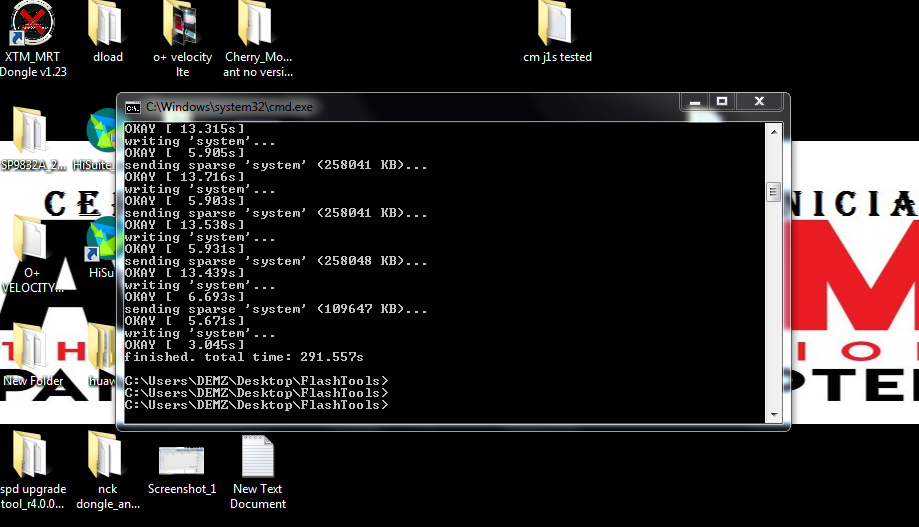

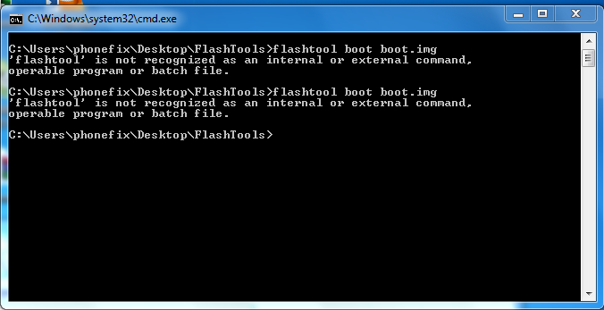

under adb command type the following here:​
flashtool boot boot.img
flashtool recovery recovery.img
flashtool system system.img
finish product​
Ok lang ba kahit yung last part gaya nito................
fastboot oem reboot-recovery?
