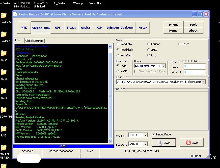

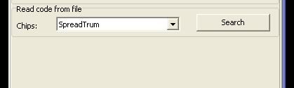

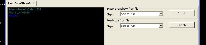

B BLIND Registered Joined Dec 23, 2014 Messages 2,965 May 9, 2015 #1 AVATOR 100% safe sa lock code no need format UNIT CHINA ZTC C7 SPEADTRUM IC PHONE LOCK read muna flash then punta ka sa tools select read code from file chips spreadtrum press seach hanapin kung saan naka lagay ang na read na file
