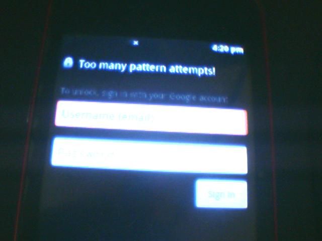

Problem:
Pattern Lock.
http://s1230.photobucket.com/user/jhony1986/media/Picture001_zps8c17ea6f.jpg.htmlhttp://i1230.photobucket.com/albums/ee489/jhony1986/Picture001_zps8c17ea6f.jpg

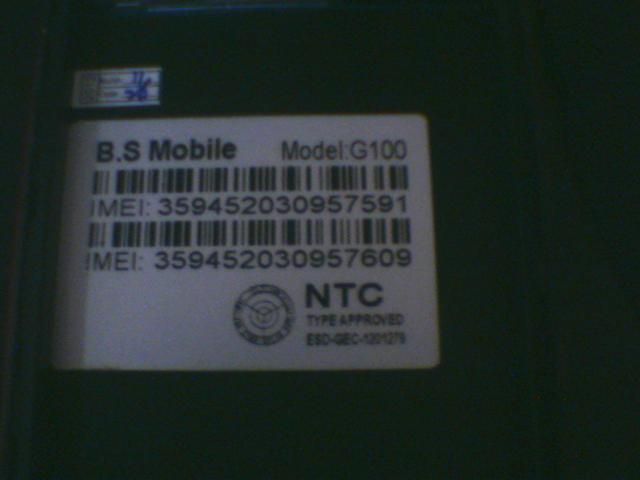

Unit:
http://s1230.photobucket.com/user/jhony1986/media/Picture002_zpsb64baff3.jpg.htmlhttp://i1230.photobucket.com/albums/ee489/jhony1986/Picture002_zpsb64baff3.jpg

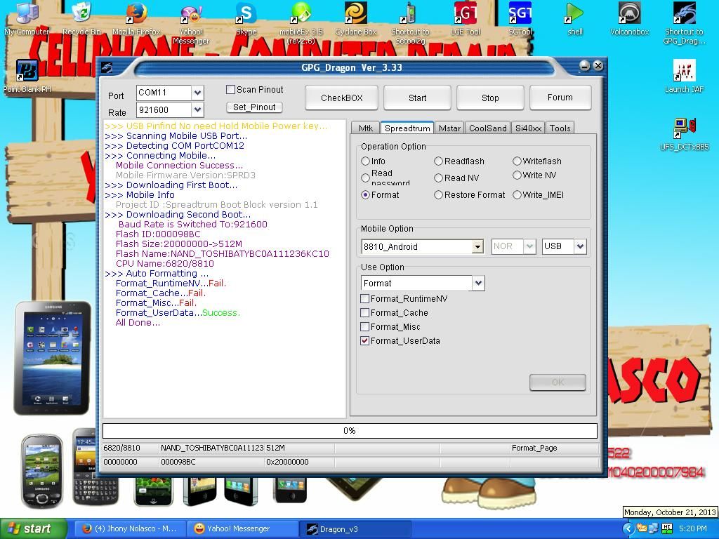

Procedure:
1. Open Dragon_V3.33A
2. Click Check Box
3. Uncheck Scan Pin out, and Set Spreadtrum Tab
4. Click Format set boot 8810_Android, and USB mode.
5. Click Start
note: dapat naka power off ang phone, at Pindutin ang Volume Down + Power Button.
sabay saksak ng USB Micro.
6. Install Driver DonwLooad Here
http://s1230.photobucket.com/user/jhony1986/media/untitled_zpsdb6e7906.jpg.htmlhttp://i1230.photobucket.com/albums/ee489/jhony1986/untitled_zpsdb6e7906.jpg
Done.

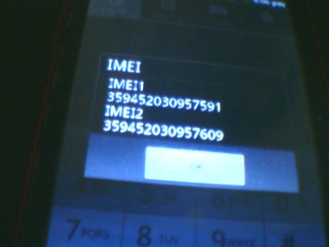

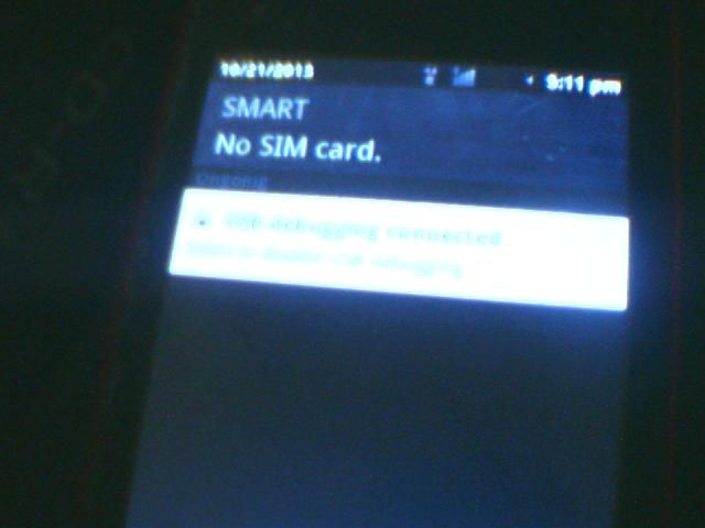

Unit
http://s1230.photobucket.com/user/jhony1986/media/Picture003_zps806063df.jpg.htmlhttp://i1230.photobucket.com/albums/ee489/jhony1986/Picture003_zps806063df.jpg
http://s1230.photobucket.com/user/jhony1986/media/Picture005_zps89491185.jpg.htmlhttp://i1230.photobucket.com/albums/ee489/jhony1986/Picture005_zps89491185.jpg
