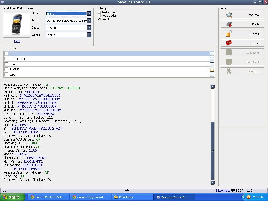

B5510 Galaxy Y PRO (2.3.6) root unlock
share ko lng po mga master.. for reference lng po..
samsung b5510 Galaxy y pro (android version 2.3.6) rooting unlock..
procedures:
1. root the phone
2. connect the phone and install driver
3. select correct com
4. choise direct unlock or read codes
*prodcedure of rooting and root file download here -----> http://theunlockr.com/2012/04/20/how...ro-duos-b5512/
pasenya po ala ako screenshot sa mismo phone nagmamadali kasi ang may ari..
