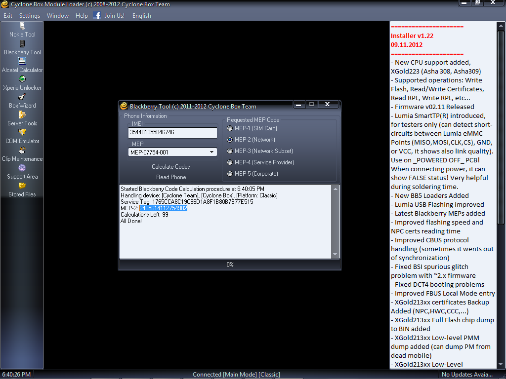

d2 naman kay cyclone,,,
1 open cyclone gui and tick on blackberry tool
2 type phones imei at ung mep code nya
3 tick calculate codes
4 insert not accepted sim then i-type ung code
hay nadali din,,,di pa rin papadaig si cyclone

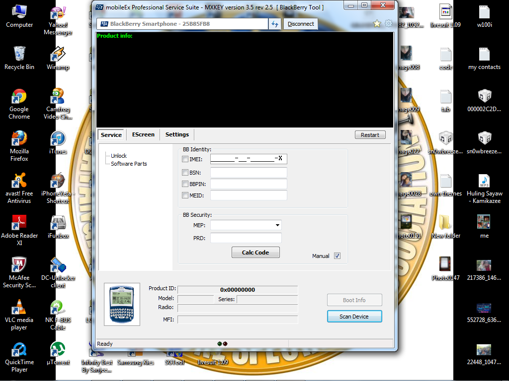

unang move try kay hti,,
1 i-on ang unit insert usb at antaying basahin ang modem
2 insert and open mx-key hti
3 select blackberry modem then connect
4 select blackberry tool then tick info
naku naman sablay agad ayaw mag info,,

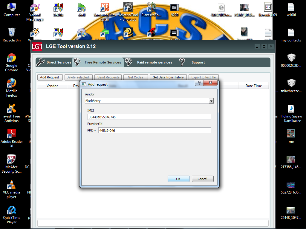

next kay lgtool naman via remote unlock,,
1 open lgetool
2 tick free remote services
3 choose vendor(blackberry)
4 put imei and prd then tick ok
5 send request then get codes

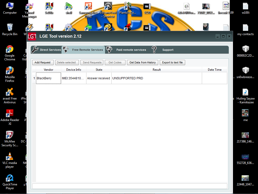

ah ah naman unsupported prd naman ang lumabas
