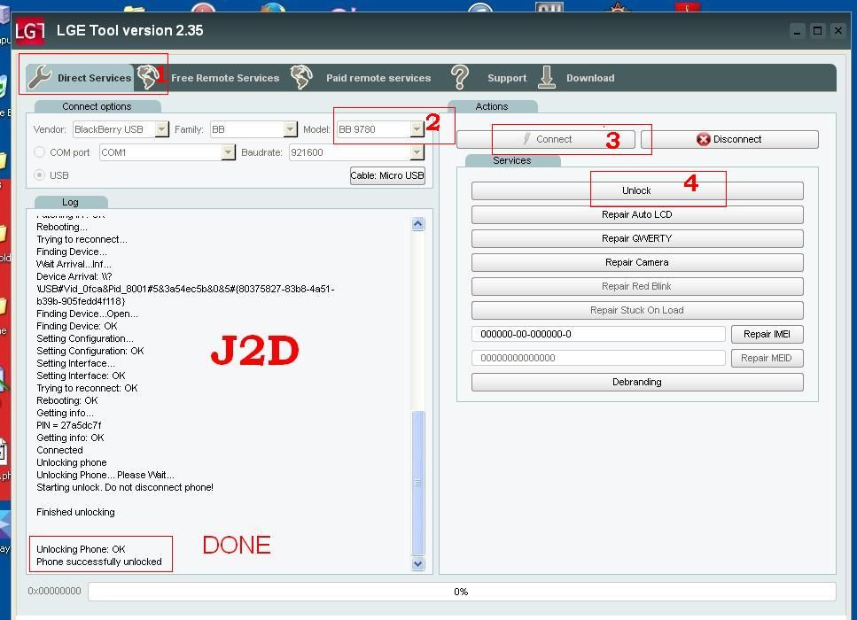

blackberry 9780 zer0-mep unlock done by LGE TOOL.
procedure: remove battery and insert micro usb usb cable open lge tool version 2.35
1. click direct services
2. select model number bb.9780
3. tick connect
4. tick unlock just wait until finished and you done.
[URL="http://i1066.photobucket.com/albums/u418/jetdayrit/captured_zpsf592b4ab.jpg"][URL="http://i1066.photobucket.com/albums/u418/jetdayrit/captured_zpsf592b4ab.jpg"][/URL][/URL]
