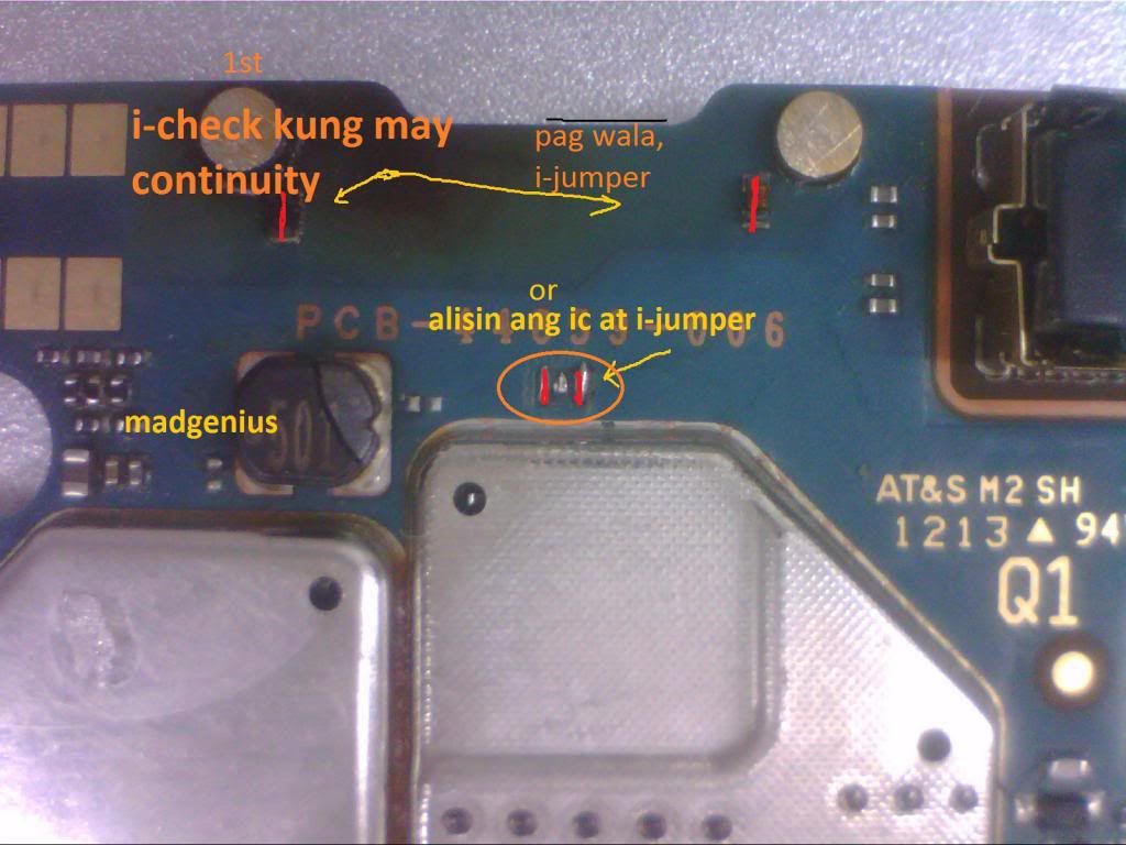

A AltF4 Registered Joined Sep 3, 2014 Messages 1,285 Reaction score 7 Points 181 Oct 3, 2014 #1 Blackberry q10 no earpiece, simple jumper solution here MAGANDANG HAPON MGA MATES DAG-DAG KO LANG TO, BLACKBERRY EARPIECE JUMPER SOLUTION.. MAY NAGPOST NA NETO, PERO DI KO MA-VIEW UNG IMAGE SA IC JUMPER NA SINASABI NYA NA NASA BABA DAW, KAYA GAYA NYA, SINUBUKAN KO NLANG UNG KARANIWANG JUMPER SA 5 DOTS NA IC.. SALAMAT AT NAG-OK NAMAN.
