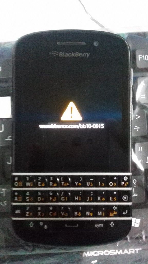

Blackberry SQN100-3 bberror.com/bb10-0015
[URL=http://s1062.photobucket.com/user/jony257/media/20160506_220237_zpsajwp17uv.jpg.html]
[/URL]

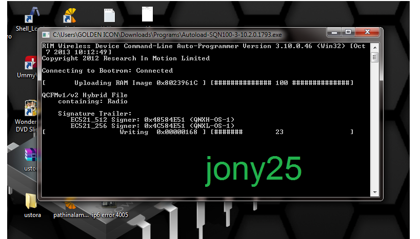

procedure
1.download first blackberry desktop manager..
and install....
2.download autoloader bb10 SQN100-3
3.run autoloader bb10 SQN100-3
4.remove battery from mobile phone
5.plugin the usb cable to the mobile phone
then insert battery
6.done.......................
screenshot
[URL=http://s1062.photobucket.com/user/jony257/media/sqn100-3_zpsoj31xhf5.png.html]
[/URL]

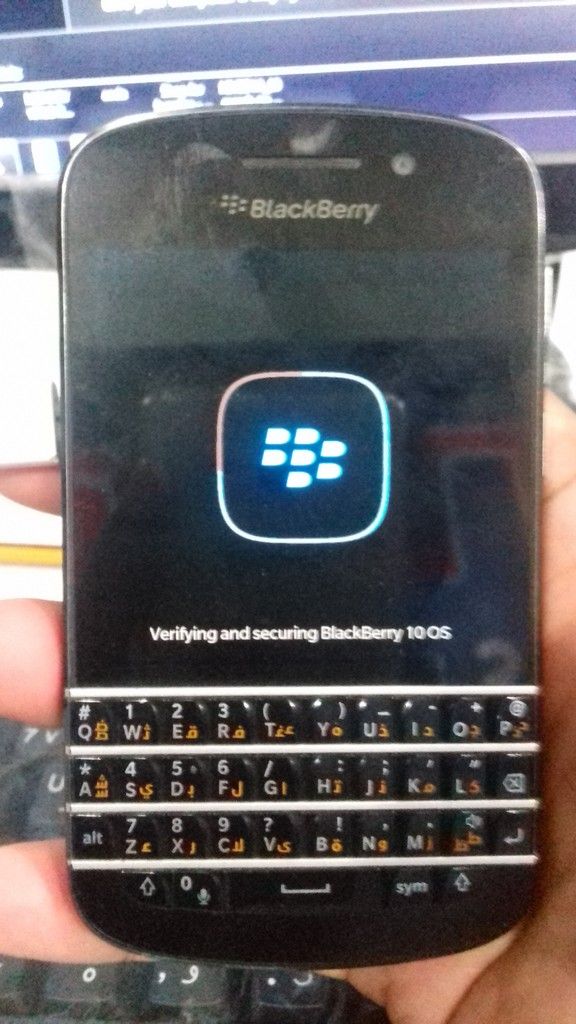

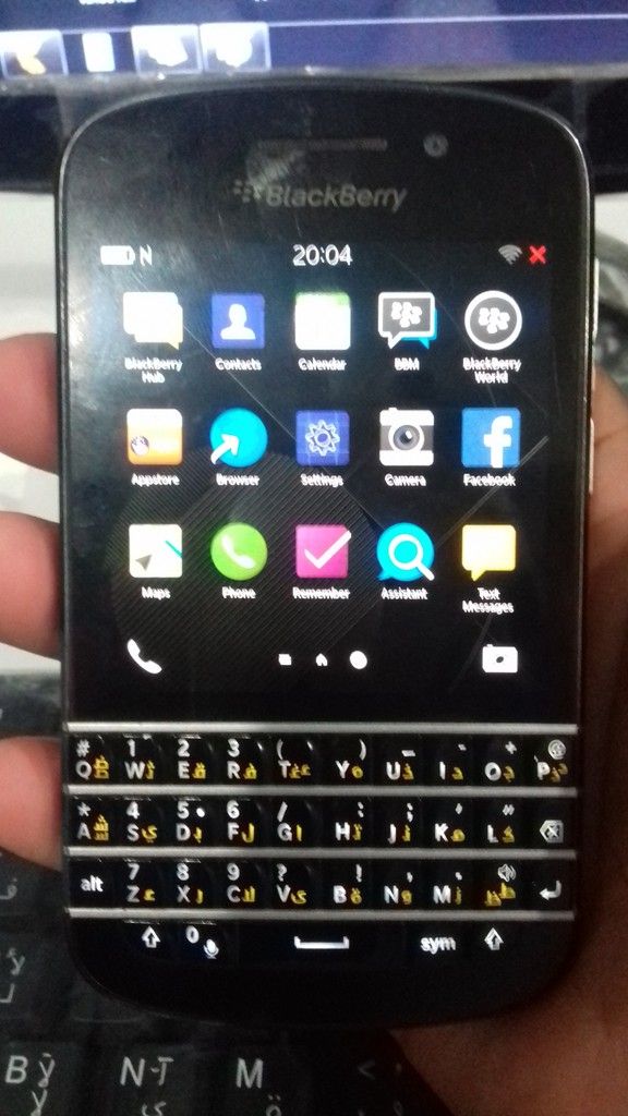

finish
[URL=http://s1062.photobucket.com/user/jony257/media/20160506_225741_zpspgtjf4ht.jpg.html]
[/URL]
[URL=http://s1062.photobucket.com/user/jony257/media/20160506_230511_zpsdkdudr2w.jpg.html]
[/URL]
[/URL]procedure
and install....
then insert battery
screenshot
[/URL]finish
