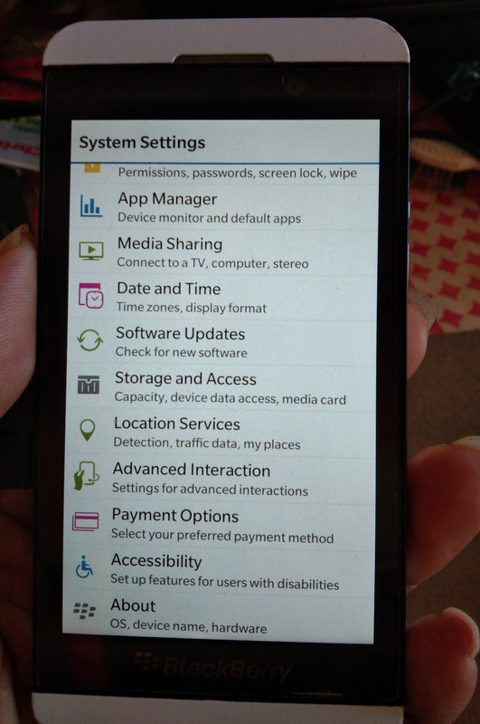

share ko lang po itong gawa ko blackberry z10 stl100-2 naka hang sa logo..
madami na ako na DL na autoloaders ibat ibang version pero hang padin..
nakita ko kay pareng google c BlackBerry Desktop Software
eto link https://drive.google.com/uc?export=download&confirm=btPS&id=1X1Up72GdTOSlZYD3ieIeUlrON057hUTg

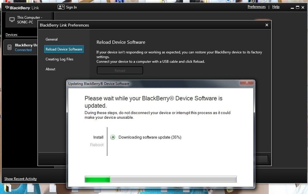

open BlackBerry Link click preference tab..click reload device tab..dapat naka off ang unit..

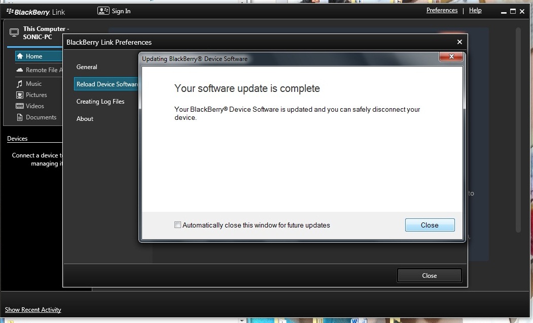

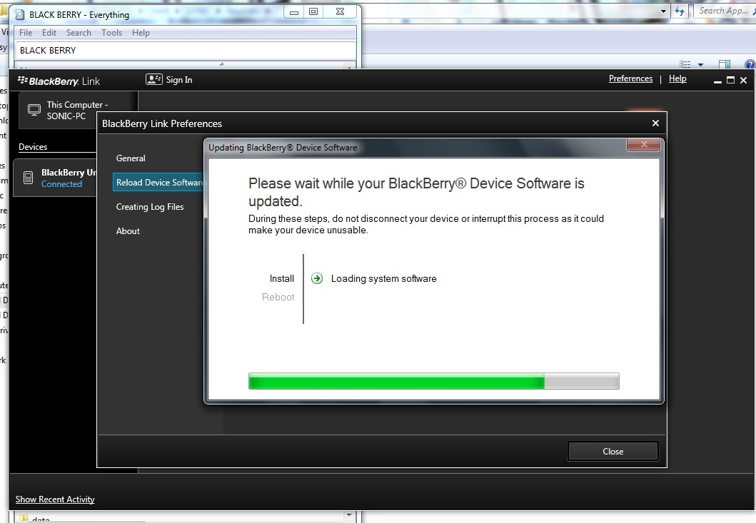

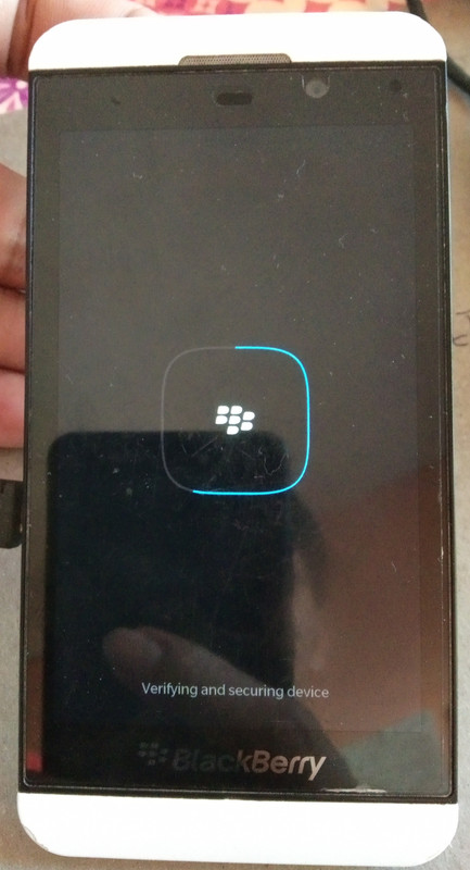

salpak muna ang unit automatic na masesearch na ng firmware update.. w8 mo lang hanggang matapos.... finish
FLASH UPDATE

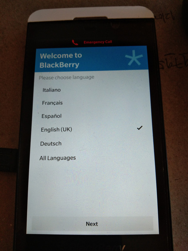

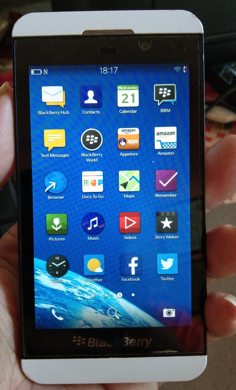

AFTER FLASH ETO NA CYA...
DONE....
