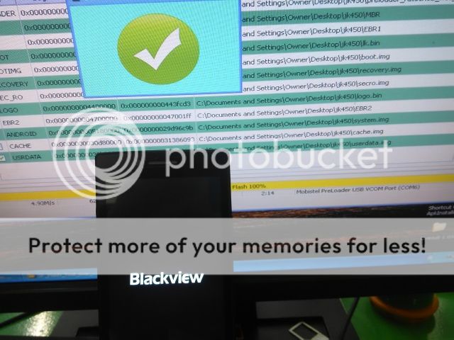

SOLUTION:
Flashing via sp flashtool
TOOLS:
Firmware/SP flashtool
download here: http://www.needrom.com/?s=blackview+jk450&sa=search&scat=0
FLASHING PROCEDURE:
Open sp flashtool
Click Scatter-loading
& load scatter file
Select download only
Click download
Press volume down & insert usb cable
Wait until flashing done....
