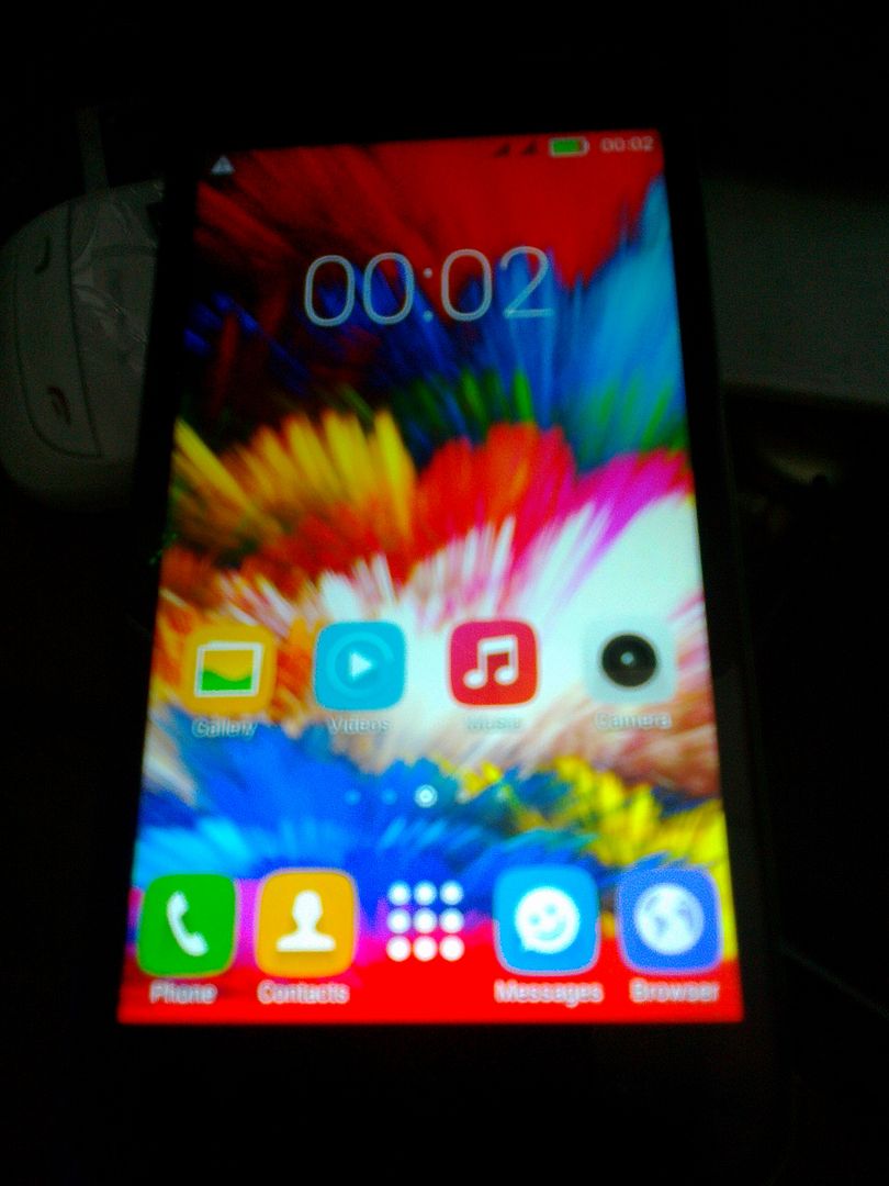

blackview zeta, privacy lock, done by freesoft
jubz
Jun 13, 2014
43
0
Phone:Blackview
Model:Zeta
Probz:Privacy lock
try to hardreset but no luck,
procedure:
open miracle crack 2.14
tick clear Anti theft,tick usb cable,then tick start button may mag pop-up (back flash before operating) yes lang, connect phone to pc (hold vol+) antayin matapos,.pagkatapos tangal,kabit battery tick ulit yung anti theft start button select NO sa pop-up connect phone then wait,,,,,,,,done.
power on the phone hang sa logo (wag kabahan)
hardreset the phone (vol+ and power on) done..
done products
maybe first in this house:-*​
