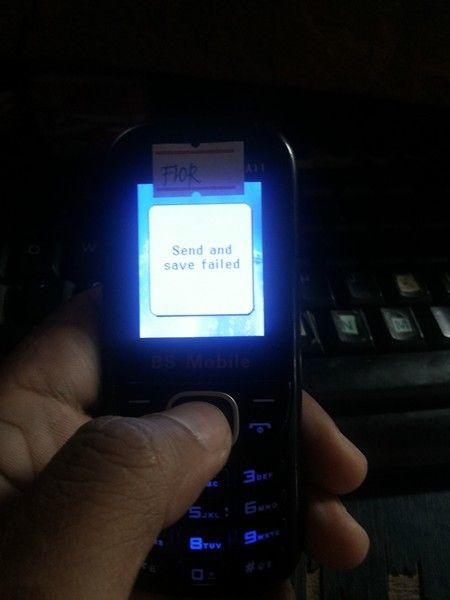

Unit: BS Mobile A11
Problem: Send failed(Messaging)
Gadget:

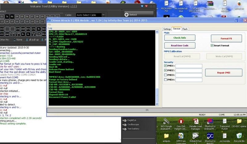

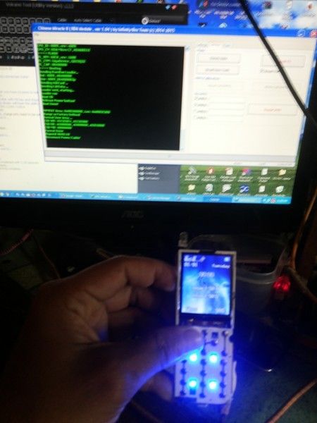

Infinity box(CM2)
Action taken:
>Reset sa Setting (send failed pa rin)
>Infinity box>InfinityBox CM2RDA
>Solder pinout(madali lang makita sa board)
>read flash ( http://www.4shared.com/file/XfctuAHmce/BSMOBILE_12_20140430_8851a_M10.html )
>service>format FS
DONE.
