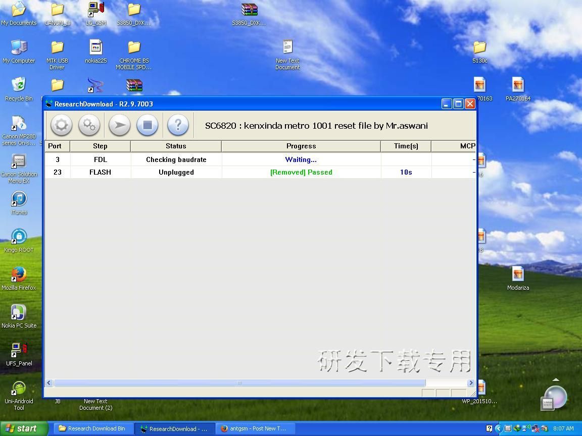

Problem TMPA
Action Taken
1. Download PAC file here
2. open Research Downloader
3. Put Pac File.. Note. Wala ng babaguhin sa settings
4.click Play and insert the mobile by pressing Vol.- and + to boot..
5. Install driver if needed.
6.Wait to finish and smile...

PROOF..
pasensya nagmamadali c tumer di na picturan ang unit nya at sya.... heheheheh:D:D:D
