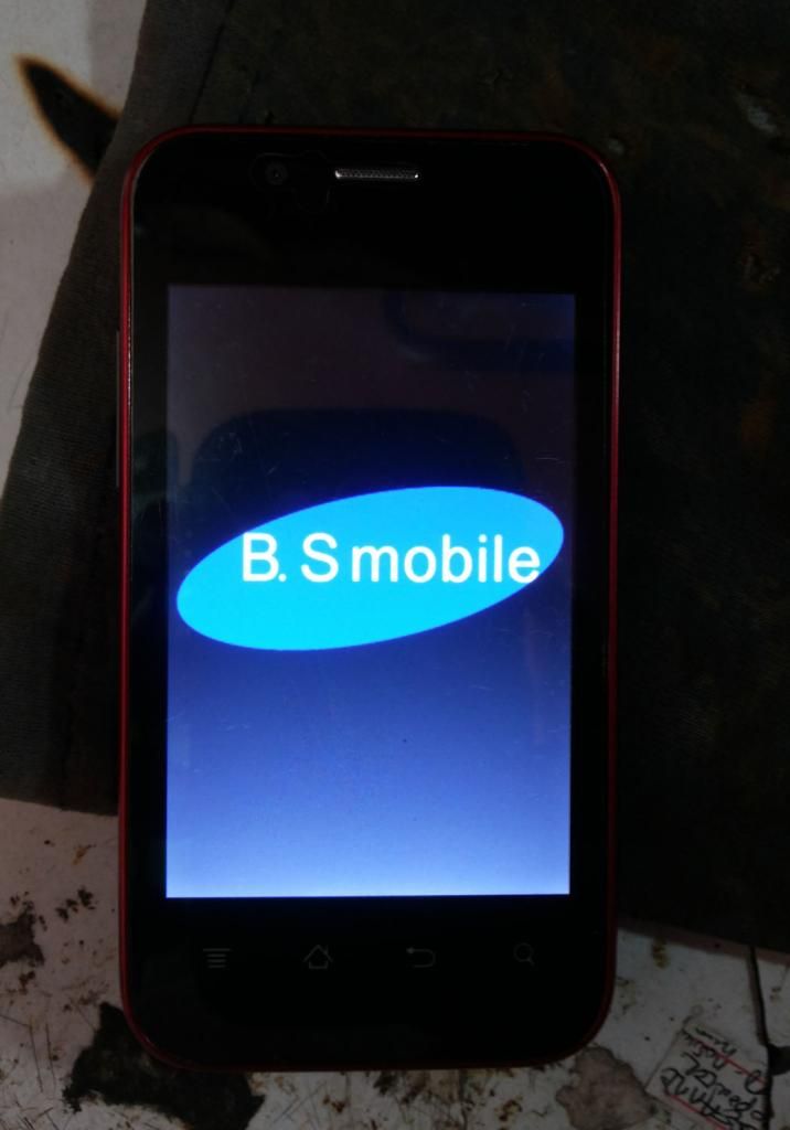

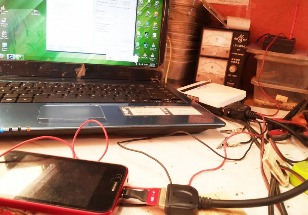

GUDDAY SHARE Q LANG PO ITONG GAWA Q
UNIT:BS MOBILE G100
PROBLEM:AUTO RESTART
HISTORY:BIGLA NALANG DAW

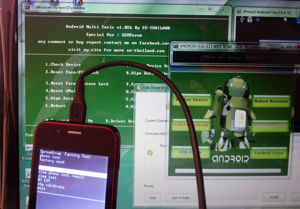

ACTION:TRY TO HR BYRESS POWER VOLUME UP,AND DOWN AT THESAME TIME NO LOCK
TRY FASTBOOT NO LOCK
TRY TO PRESS POWER AND VOLUME UP THE SAKSAK Q SA LAPY UN LUMABAS ANG DEBUGGING NO LOCK
NOTE:KAILANGAN Q CYANG I FACTORY TEST PARA HND CYA MAG RESTART..NOLCK

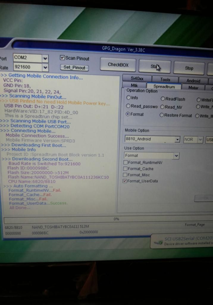

LASTLY OPEN GPG SUNDAN NYO NALANG MGA IDOL..\
GANITO CYA AFTER 2 LESS DAN 1 MINUTE OFF RESTART.

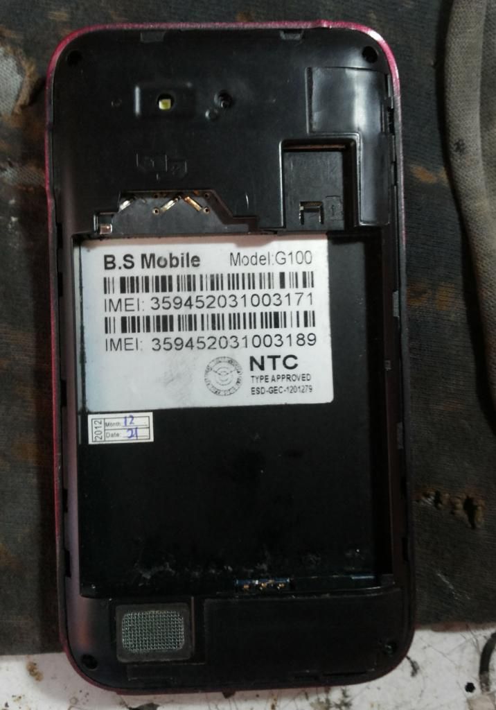

YAN ANG UNIT
YAN SINUBUKAN Q YANG TATLO PERO NO LOCK
CYA NGA MARAMI NITO DITO SA ATING TAHANAN SA MGA NAGHAHANAP(KAILANGANG NAKA FACTORY TEST PARA HND MAMATAY
KUNG PAANO PRESS POWER AND VOLUME UP
YAN CONNECTED NA

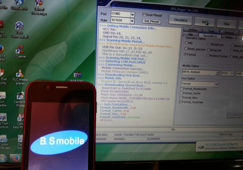

YAN PO DONE,,,
HND Q NA BINAK UP MGA BOSS BAKA MAG HAHANAP KAYO

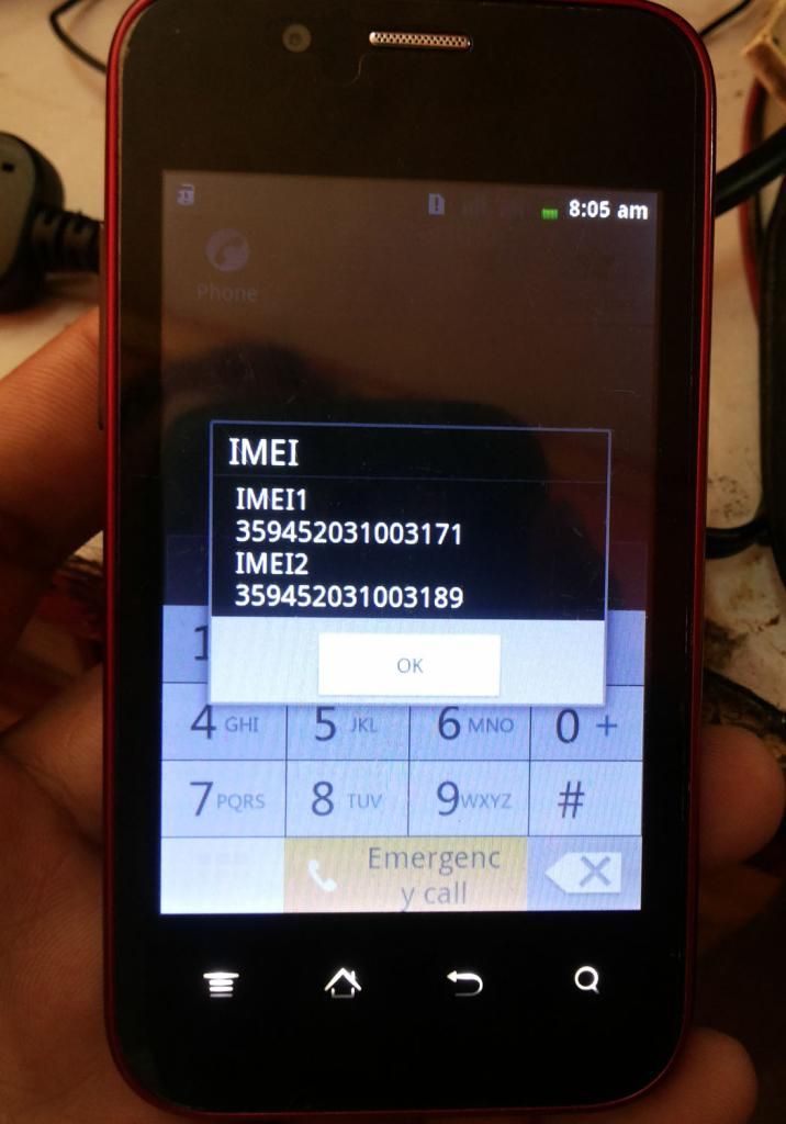

TAPOS TESTING Q I POWER YAN POWER NA
