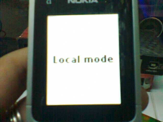

MAG BOSS SHARE KO LNG PO C1-01 LOCALMODE
HISTORY BIGLA NLNG DAW PO NGKAGANUN ANG UNIT
DINALA PO SAKIN AY LOCAL MODE NA SIYA
PINACHECK NIYA DAW PO SA IBA MAHAL DAW ANG PAGAWA AABUTIN DAW NG 600
SABI KO NAMAN SUBUKAN PO NATIN GAWIN SA 400
PUMAYAG NAMAN PO ANG MAY ARI
KAYA GINAWA KO AY FLASH PO MUNA SA MXBOX

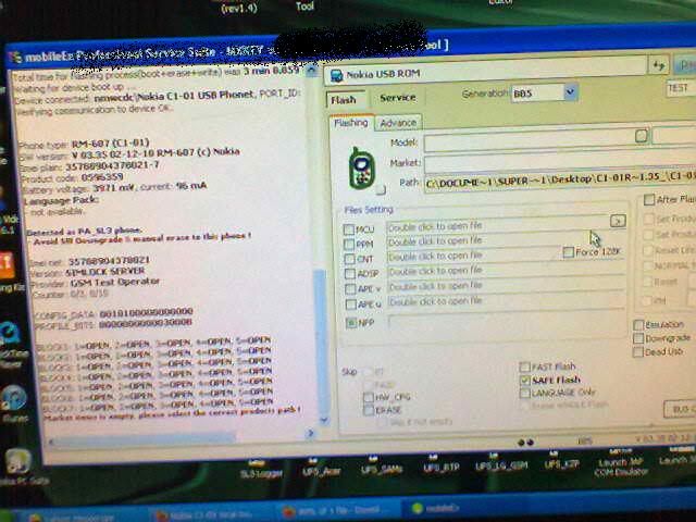

PROCEDURE
OPEN MXBOX
SELECT USB PORT
LOAD FILE MCU PPM CNT
THEN CLICK FLASH WAIT UNTIL DONE
HTML:
MXKEY [MxKey Team HTI Flasher Interface (WinUSB) 4], SN: C08594A0
Connection status: UHCI:HUB:HUB::USB 1.10 (Full-speed)
Driver: nmwcdnsuc, ver: 7.1.32.67
Module ver: 1.0.0.19045(08-10-2011), Library ver: 1.0.0.12920(08-10-2011)
Make sure USB cable, Battery and charger are removed from device.
Insert USB cable, Battery back to device(make sure to have fully charged battery).
Insert Charger or Press phone's power button(if flashing doesnt start automatically)
Waiting for USB device ...
Device connected: nmwcdnsuc\Nokia USB Flashing Generic, PORT_ID: 3038FEBF
Device synchronized.
CPU: XGOLD 213
Sending EBL Loader...OK
Sending EBL ...OK
Getting EBL Version ...
Boot mode: 0xCC
EBL version major/minor: 3.35
EBL version : Quantum_Bootloader_10.37_M1S1
Protocol version suggested by phone: 3
Set baud rate to: 6.50 Mbps
Flash ID: 00EC 3012 [Samsung ]
Processing file: rm607__03.35.mcusw
Downloading item CODE:rm607__03.35.mcusw_ebl_psi.fls, num block: 5, size: 25 MB
Erasing area 0x40000000-0x4001FFFE ...OK
Programming completed in 0.406 s
Erasing area 0x40040000-0x4007FFFE ...OK
Programming completed in 0.594 s
Erasing area 0x40080000-0x4009FFFE ...OK
Erasing area 0x400A0000-0x4019FFFE ...OK
Programming completed in 1.953 s
Erasing area 0x40400000-0x41B7FFFE ...OK
Programming completed in 27.438 s
Checksum verified (0xF9E2)
Processing file: rm607__03.35.ppm_m_a
Downloading item CUST:package_m_a.ppm_ebl_psi.fls, num block: 1, size: 3.15 MB
Erasing area 0x41C00000-0x41F258DE ...OK
Programming completed in 3.891 s
Checksum verified (0x7440)
Processing file: rm607__03.35.image_m_a_0596697
Downloading item CUST:package_m_a_0596697.image.fls, num block: 1, size: 11.25 MB
Erasing area 0x42200000-0x43E5FFFE ...OK
Programming completed in 13.610 s
Checksum verified (0xED14)
Total time for flashing process(boot+erase+write) was 3 min 8.859 s
Waiting for device boot up ...
Device connected: nmwcdc\Nokia C1-01 USB Phonet, PORT_ID: 3481522
Verifying communication to device OK.
Phone type: RM-607 (C1-01)
SW version: V 03.35 02-12-10 RM-607 (c) Nokia
Imei plain: 35788904378021-7
Product code: 0596359
Battery voltage: 3971 mV, current: 96 mA
Language Pack:
- not available.
Detected as PA_SL3 phone.
- Avoid SW Downgrade & manual erase to this phone !
Imei net: 35788904378021
Version: SIMLOCK SERVER
Provider: GSM Test Operator
Counter: 0/3, 0/10
CONFIG_DATA: 0010100000000000
PROFILE_BITS: 800000000003000B
BLOCK1: 1=OPEN, 2=OPEN, 3=OPEN, 4=OPEN, 5=OPEN
BLOCK2: 1=OPEN, 2=OPEN, 3=OPEN, 4=OPEN, 5=OPEN
BLOCK3: 1=OPEN, 2=OPEN, 3=OPEN, 4=OPEN, 5=OPEN
BLOCK4: 1=OPEN, 2=OPEN, 3=OPEN, 4=OPEN, 5=OPEN
BLOCK5: 1=OPEN, 2=OPEN, 3=OPEN, 4=OPEN, 5=OPEN
BLOCK6: 1=OPEN, 2=OPEN, 3=OPEN, 4=OPEN, 5=OPEN
BLOCK7: 1=OPEN, 2=OPEN, 3=OPEN, 4=OPEN, 5=OPEN

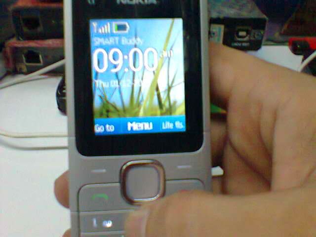

DONE NAMAN PO MGA BOSS
PERO GANUN PADIN
BALAK KO BUKSAN ANG UNIT
PERO ISIP MUNA AKO MABABA KASI UNG VERSION BAKA SA FILE LANG NGKATALO
KAYA DOWNLOAD AKO NG FILE 10.37 UNG PINAKAMATAAS PARA SIGURADO
HERE
THE LOGS
HTML:
Driver: nmwcdc, ver: 7.1.32.67
CPU: XGOLD 213
Sending EBL ...OK
Boot mode: 0xCC
EBL version major/minor: 10.37
Processing file: rm607__arc6.10.mcusw
Downloading item CODE:rm607__arc6.10.mcusw_ebl_psi.fls , num block: 5, size: 25 MB
Programming completed in 0.422 s
Programming completed in 1.438 s
Programming completed in 27.609 s
Checksum verified (0x81D9)
Processing file: rm607__arc6.10.ppm_mh
Downloading item CUST:package_mh.ppm_ebl_psi.fls, num block: 1, size: 3.83 MB
Erasing area 0x41C00000-0x41FD49B2 ...OK
Programming completed in 4.719 s
Checksum verified (0x959A)
Processing file: rm607__arc6.10.image_mh_0595599
Downloading item CUST:package_mh_0595599.image.fls, num block: 1, size: 12.63 MB
Programming completed in 16.000 s
Checksum verified (0xACFD)
Total time for flashing process(boot+erase+write) was 3 min 18.140 s
SW version: Vp arc6.10 19-10-11 RM-607 (c) Nokia
Battery voltage: 3971 mV, current: 92 mA
Language Pack:
- not available.
Counter: 0/3, 0/10
DONE
400PINDOT :))
