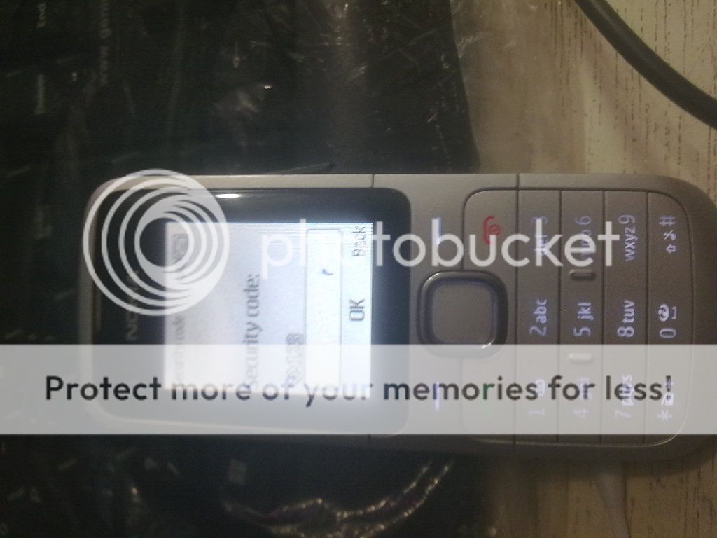

C1-01 rm-607 Sec. code done by Infinity BEST

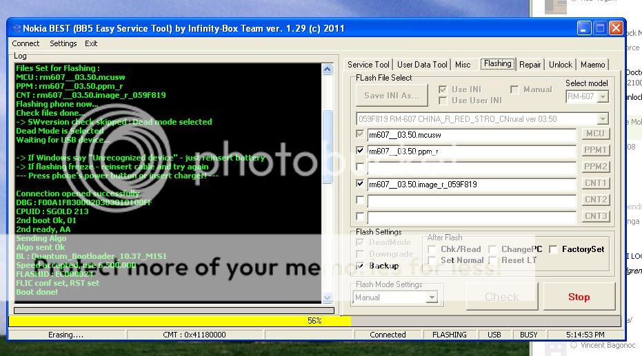

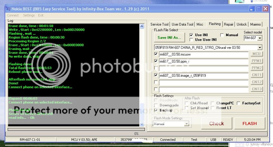

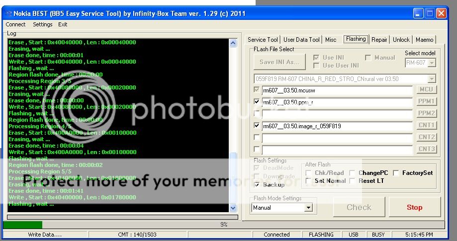

Tools:
INfinity BEST dongle
Usb micro
Procedure:
-Tick Flashing tab
-Select phone model(software automatically select ppm mcu cnt when selecting product code you want to flash)
-In flashing mode tab select manual.
-Tick flash then press power on shortly or insert charger to phone.

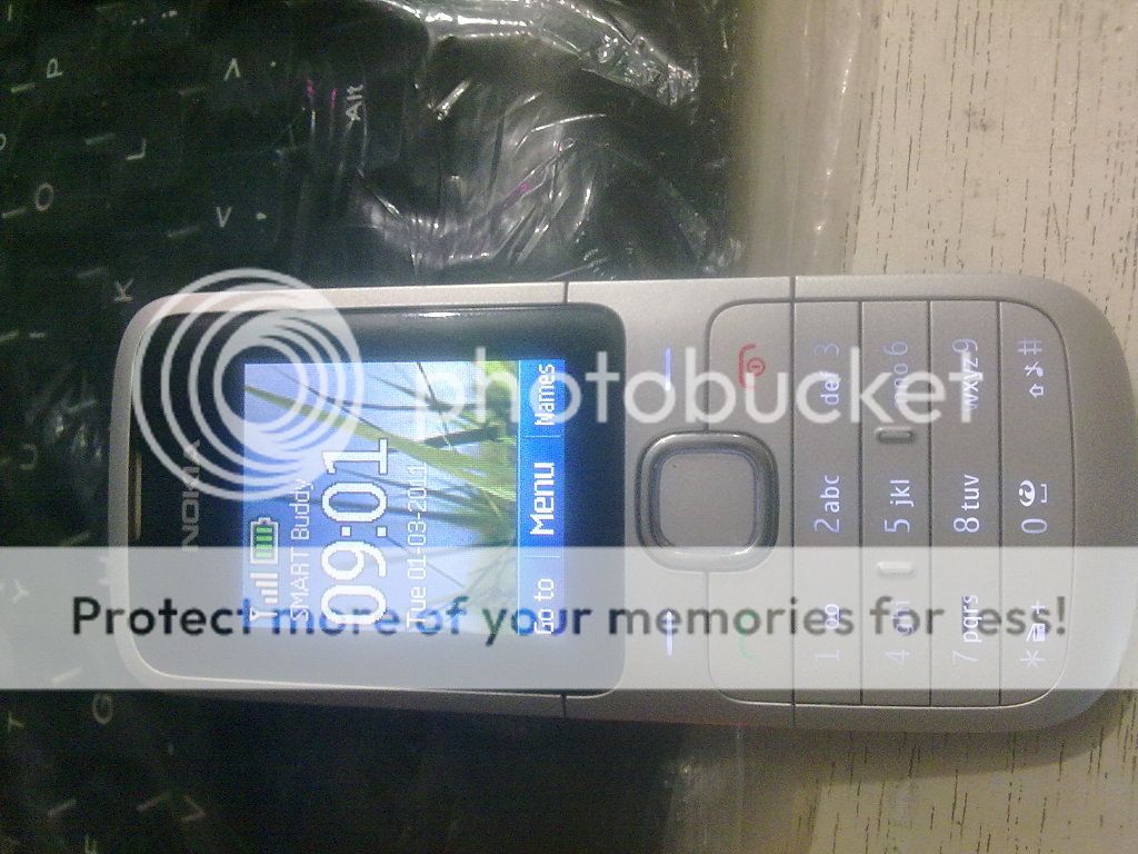

-Done.
Sreenshots:
Flashing lang tanging solution sa sec. code ng C1-01..
