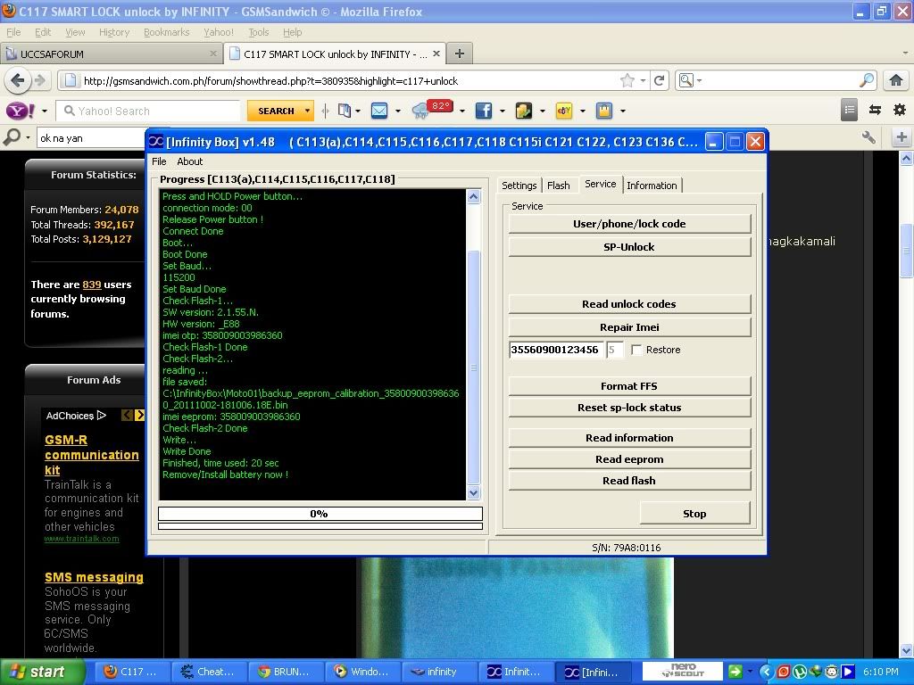

share ko lang gawa ko ngayon,grabe ang tumal buti may napadaan c117,unlock...nagising tuloy ang toys kong natutulog,hehehe,c infinity.
tools: infinity,x60 cable
procedure: open infinity shell,
select model,
then click run,,
then settings tab,
click COM-3 VCO,
then hit SP-Unlock,
then power on the unit w/d batery
hintayin matapos....smile
heres the screenshot..
