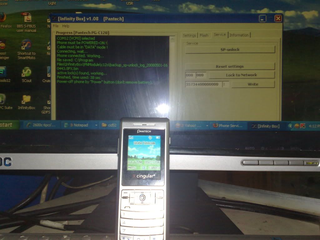

C120 pantech cingular unlock
pinout
keyboard top
1.........24
3: connect to phone pin 4
4: connect to phone pin 3
10: Phone Rx (RJ-45 pin-2)
11: Phone Tx (RJ-45 pin-3)
24: Gnd
logs
COM12 [VCP0] selected
Phone must be POWERED-ON !
Cable must be in "DATA" mode !
Connecting, wait...
Phone connected. Working...
file saved: C:\Program Files\InfinityBox\PNModule\c12o\backup_sp-unlock_log_20080501-160443.8FX.bin
active lock(s) found, working...
Finished, time used: 38 sec
Power-off phone by "Power" button (don't remove battery).
