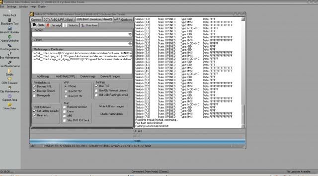

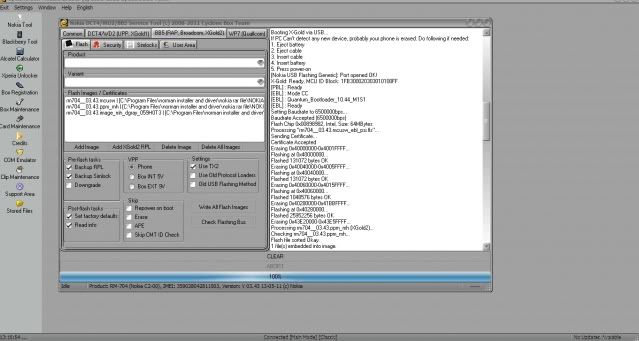

OPEN CYCLONE BOX
NOKIA TOOL
CONNECTION check usb
BACK TO BB5[RAP,BROADCOM,XGOLD}
SET flash file
WRITE ALL FLASH IMAGES
connect USB CABLE
power on the phone
