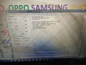

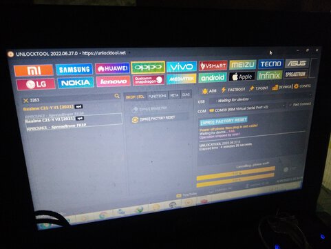

try ko kay unlocktool fail nalabas
eto yung tools credit sa nag upload https://mega.nz/file/cxBBUKyb#W2z9DyYzujnO0Yivesdmj74VXdlaxPwB5AKtUXne7JI

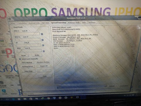

buti nalang meron ako crack ng avengers main sprd
procedure
1. open avengers main 1.8 crack
2. select spreadrum diag
3.click enter diag
4.off ang phone then connect wait pag na read yung phone
5. click factory reset
wait ma read ang phone
6. wait mag automatic reset yung phone

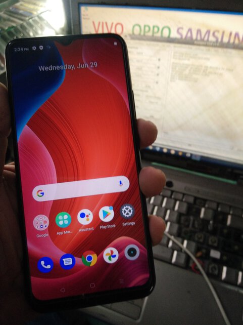

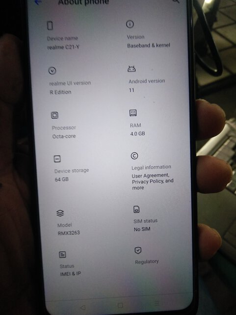

7. may frp dial *#813#
done
procedure
3.click enter diag
done
