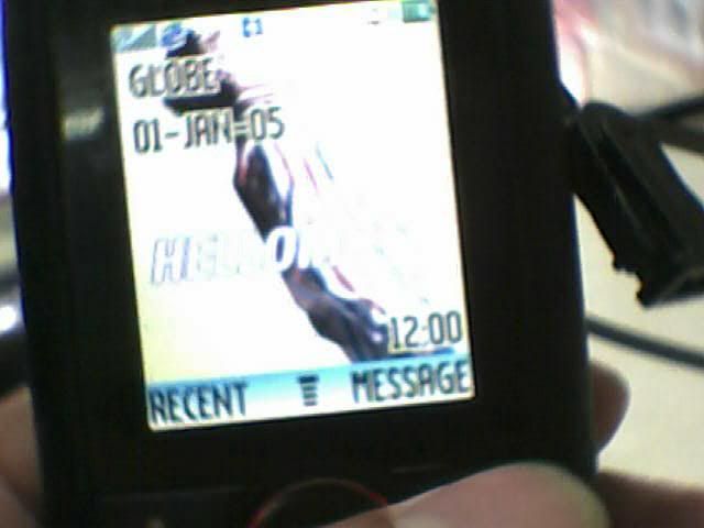

C261 After Unlock Rebooting (Solved) Infinty Box
C261 (SUN PROVIDER LOCK)
Procedure :
Select Motorola
Tick C261
Tick SP-Unlock
Unlock Using Infinity Box but got this error error: errorcode#50: eeprom can't be erased
Problem :
unlock step-1 Ok
unlock step-2 Ok
unlock step-3 Ok
unlock step-4 Ok
unlock step-5 Ok
Finished, time used: 39 sec
Remove/Install battery now !
Action :
Try to Format FFS no luck
Try to Flash Firmware,Laguage,Flex no luck=
Solution :
Connect Phone
Tick SP Unlock
Hold Power ON Until Done
Dont Release (Hold Power ON) Until DOne !!!
Unlock Done !!! Reboot Done !!!
no more error
