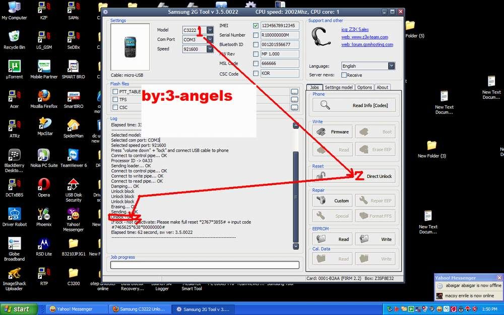

hay salamat naka buenas din samsung c3222 unlock done w/procedure..
procedure:
1. open samsung 2g Tool
2. select c3222
3. Click Direct Unlock
4. Press "volume up" + "lock" and connect USB cable to phone
Selected model: C3222
Selected com port: COM3
Selected speed port: 921600
Press "volume down" + "lock" and connect USB cable to phone
Connect to control pipe... OK
Processor ID -> 0A33
Sending loader... OK
Connect to write pipe... OK
Connect to read pipe... OK
Damping... OK
Unlock block
Unlock block
Unlock block
Erasing... OK
Sending... OK
Unlock - ok
If lock - not deactivate: Please make full reset *2767*3855# + input code #7465625*638*00000000#
Elapsed time: 62 second, sw ver: 3.5.0022
