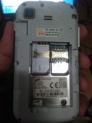

may natira pa..
sun lock..

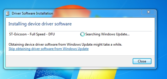

i used z3x samsung 2g tool

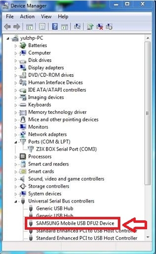

install muna driver
boot key volume down + lock key insert usb
dapat ganito lumabas
USB DFU DEVICE

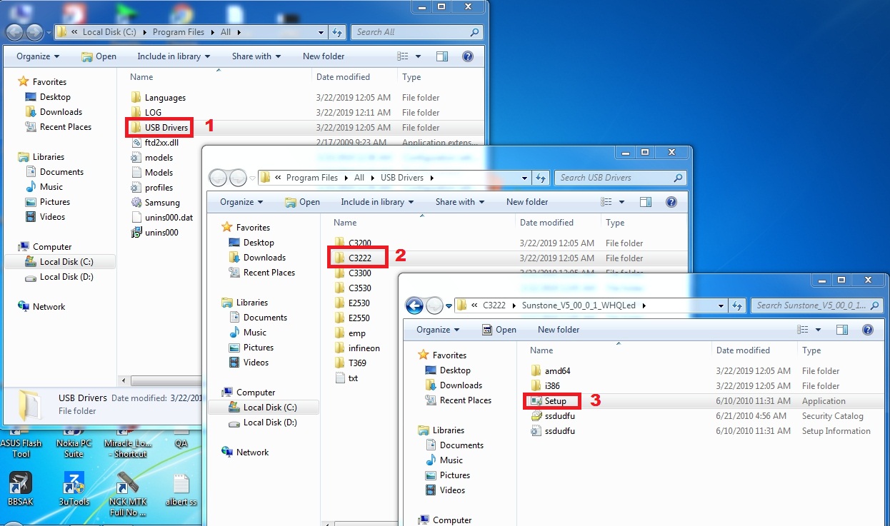

ang driver makikita sa loob ng 2g tool

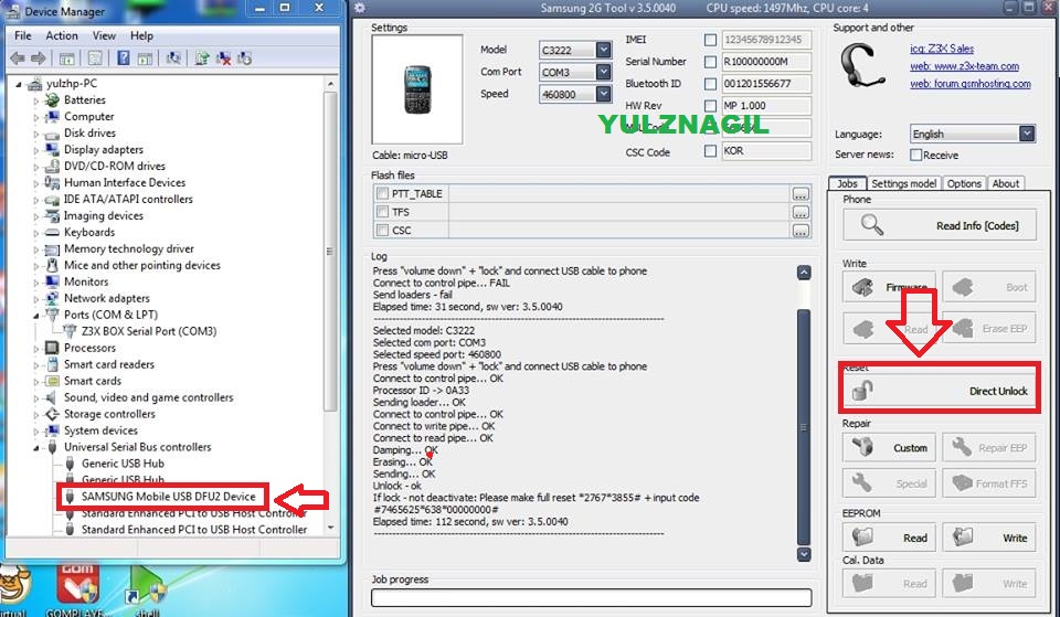

after that open na 2g tool

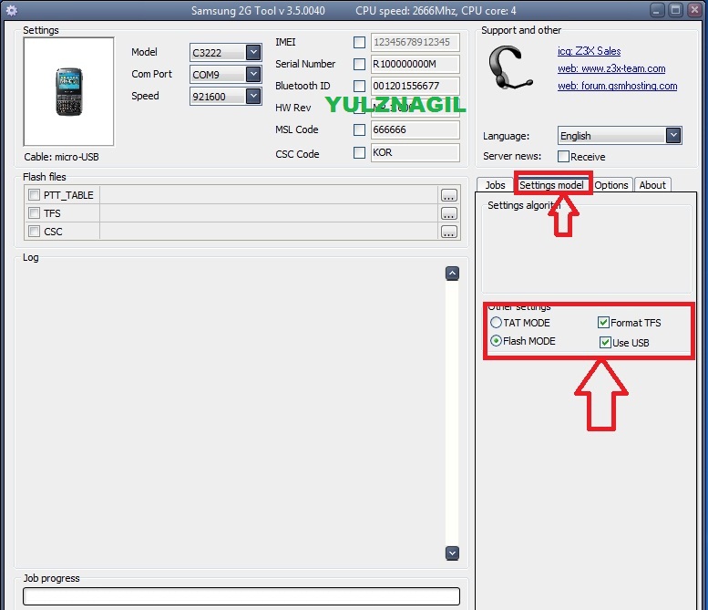

in settings tab tick Flash Mode\ Use USB
then Tick Direct Unlock

hintayin matapos..

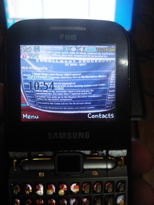

DONE
install muna driver
USB DFU DEVICE
