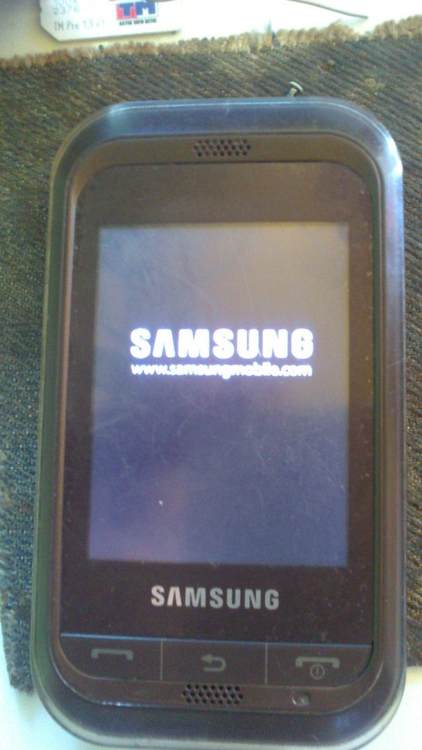

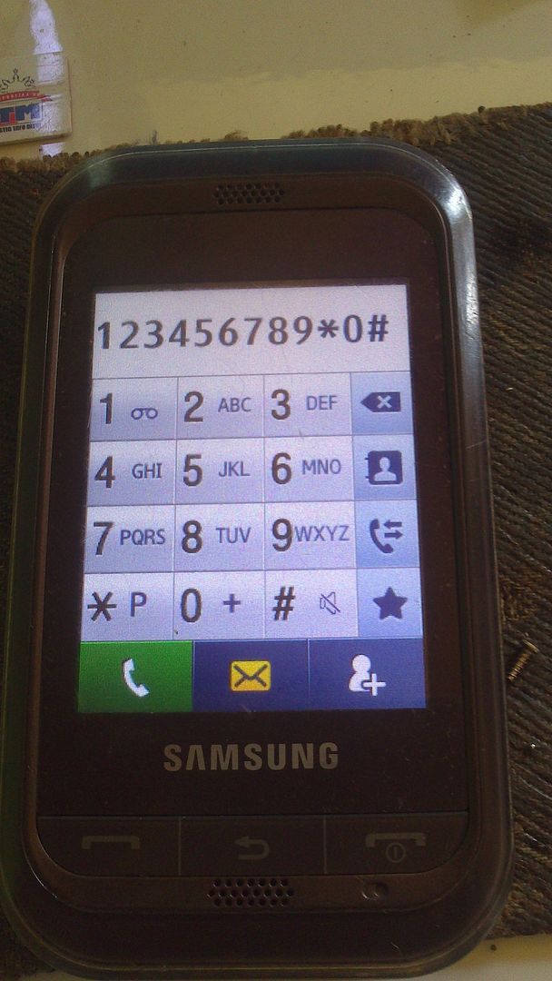

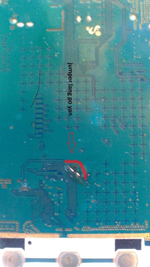

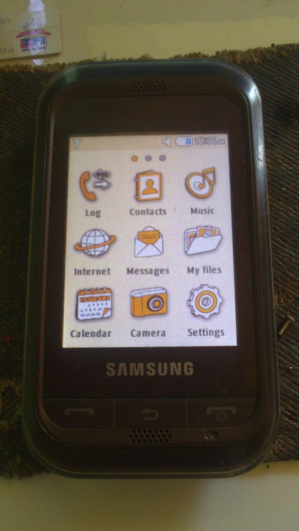

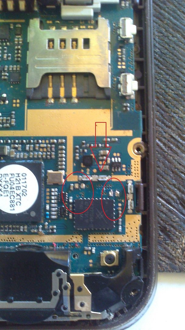

P prince vhanz Registered Joined Aug 14, 2014 Messages 412 Reaction score 2 Points 31 Location bukidnon Jun 20, 2015 #1 share ko lang po mga boss,,,,,,,,,,,,, c3303i no power ayaw i detect sa pc kaya dismantle unit and try ko po remove to no lock sundan lang po ito,,,,, ito na po xa after ma jumper po,,, done,,,,
JMGadgets Registered Joined Jul 26, 2014 Messages 656 Reaction score 0 Points 81 Location Angono Rizal Aug 8, 2015 #2 Sorry Medyo Slow ako sir pero sang parts sya at paanu nyo nalaman na dyan sira? Sa switch ways ba sya? o may sunog?
P prince vhanz Registered Joined Aug 14, 2014 Messages 412 Reaction score 2 Points 31 Location bukidnon Aug 13, 2015 #3 nakita ko po boss na may putol so try ko po jumper di rin po yan detected sa pc boss,,,,,,,,,,,,,,

jerry21 Registered Joined Apr 19, 2015 Messages 222 Reaction score 0 Points 1 Aug 13, 2015 #7 inalis ang dalawang capasitor ni ts sa tabi ng P.A. hindi ba nasira ang signal nya amo?
